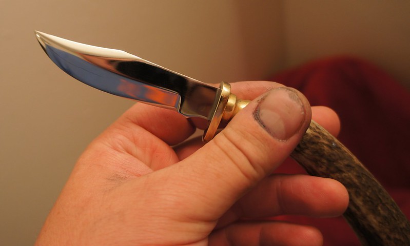

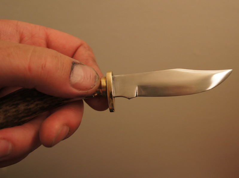

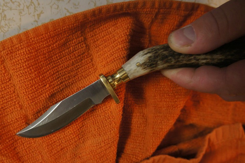

Before finishing (pic doesn't show it but there were grind lines on the grind):
Here's one side I temporarily finished only to a satin finish with 600 grit. Should have went to 800.
Here is the mirror finish with no edge (as evidence):
Final product.
I assumed this project was going to turn into a disaster. Most likely at the resharpening/regrinding point. But hey, check it out, a miracle!
