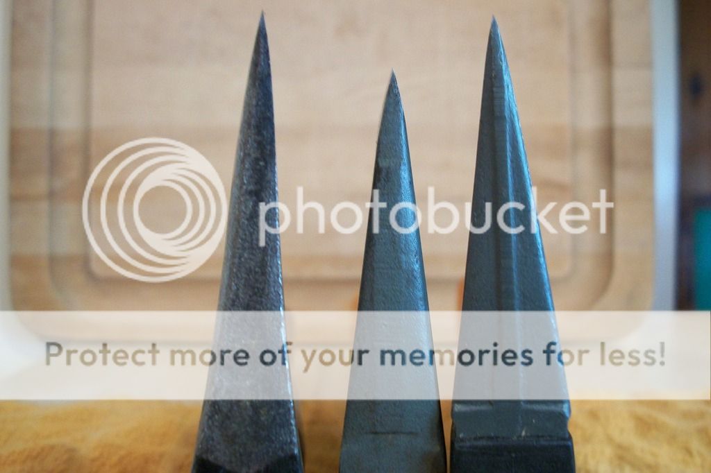

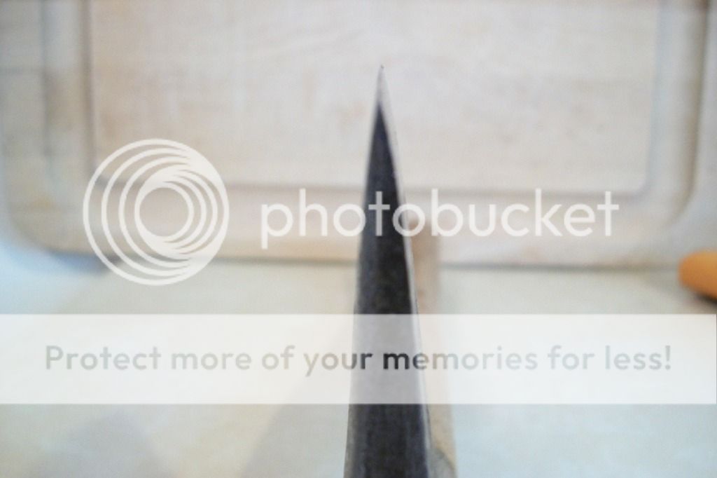

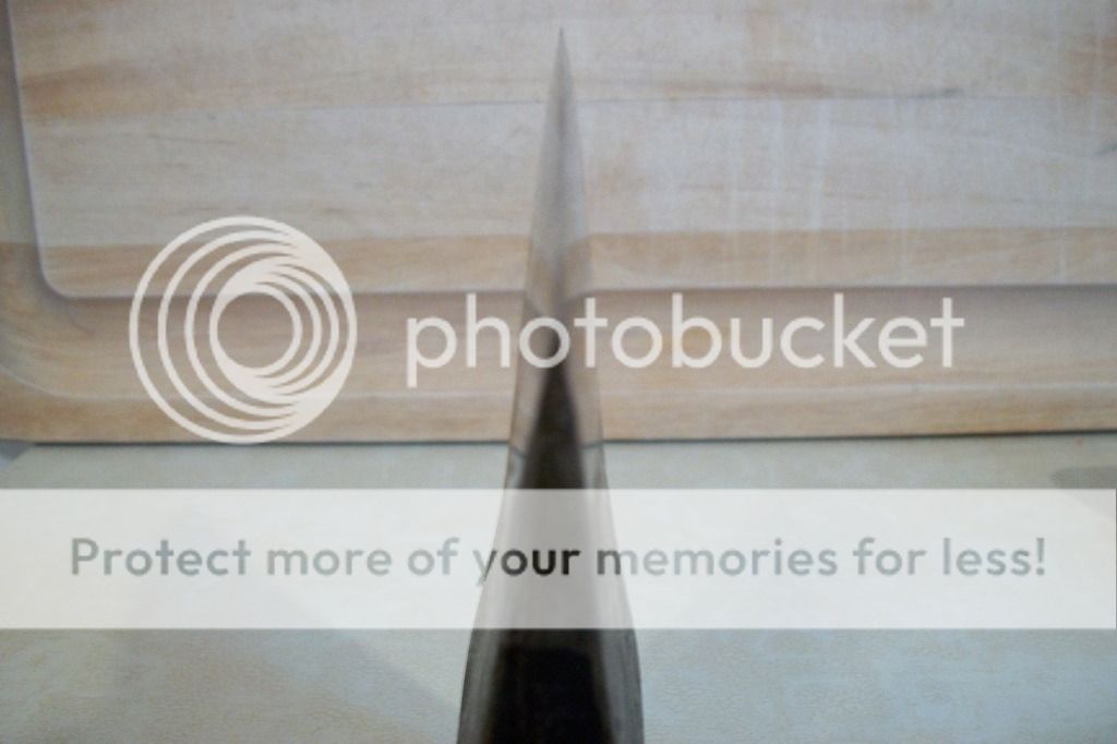

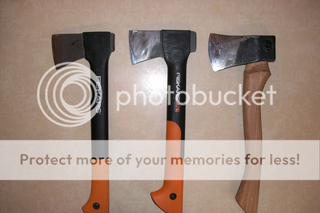

Alright, here are a few pics to go along. The Fiskars have been reviewed extensively, so I'll just stick to general observations. The older model Fiskars has the lighest weight at just under 1.5lb total and longest handle. The X7 weighs just over 1.5 total and has handle length equal to the TruTemper which weighs 2lb total, more than I thought. Also are views of the bit on the TruTemper from the bottom and the top - it looked nothing like that off the shelf.
My personal ranking is for the TruTemper, older Fiskars, and X7 last. The X7 is a beast of a splitter , but wooden wedges can be used for a lot of that when camping. The older model chops very well but is no fun to use choked up for more detail work.
I still recommend the Fiskars as a good if not great hatchet in general, especially for the price - it actually works well right off the shelf and even better if the shoulders are knocked down some. A bit of extra work on a traditional pattern really paid off though. The Fiskars being V bevel back to the "eye", can only be thinned so much at the bit before they turn into FFG. I might have to go back and taper them heel to toe and see what the effect is on that pattern. On a traditional it seems to have a compound wedging effect.
TruTemper, older model Fiskars, X7
bottom of TruTemper
Top of TT
