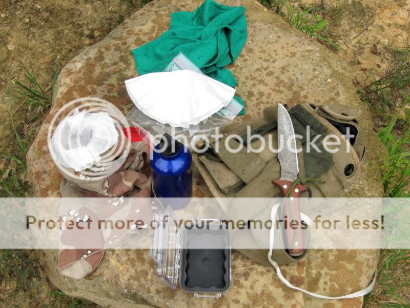

When I left the house this morning the plan was to try out the Mega warthorn that Bryan sent for me to check out, and work on a trap design with some of the Honey Locust thorn he sent me. However, Mother Nature is not always cooperative and the rains set in again. Checking the forecast and learning that today was supposed to be better than the storms predicted for tomorrow I decided to not let the day be a complete loss and headed on into the woods anyway. Since the topic of first stage and improvised water filtration was brought up here yesterday... today seemed like a good day to work on that subject. So, following is one method using commonly available household materials I have used in the past.

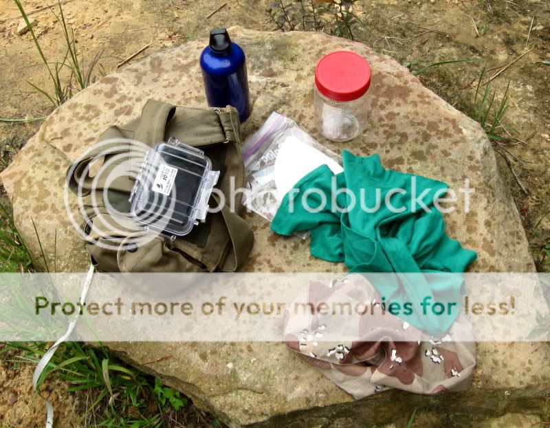

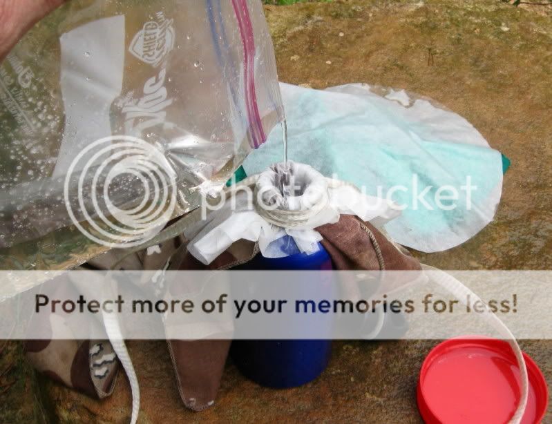

The materials used are a jar for collection, a coffee filter for obvious reasons, a bandanna to serve as a basket for the filter (which will also filter out larger particulates on it's own), some cordage...in this case some narrow webbing but fishing line or a boot lace would work just fine, a zip lock bag, and a random piece of cloth.
The water source is a small lake on top of the southern end of Walden's Ridge.

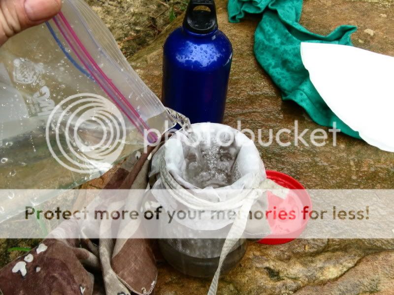

Someone brought up that coffee filters are not self supporting yesterday and that's pretty well right, they really are not when it comes to larger mouthed vessels...but a little cordage and some clothe like a bandanna or a shirt can solve that part of the problem. For the filter I placed a coffee filter on a bandanna and pushed both into the mouth of the jar.
If you have your coffee filters stored in a zip lock bag as I do then that bag will work really well for the initial water collection. Then just pour the water through your filter.
and the same methods will work for small-mouthed bottles as well, and with a smaller mouthed bottle a coffee filter alone will support itself if placed in the opening so that it balances itself.

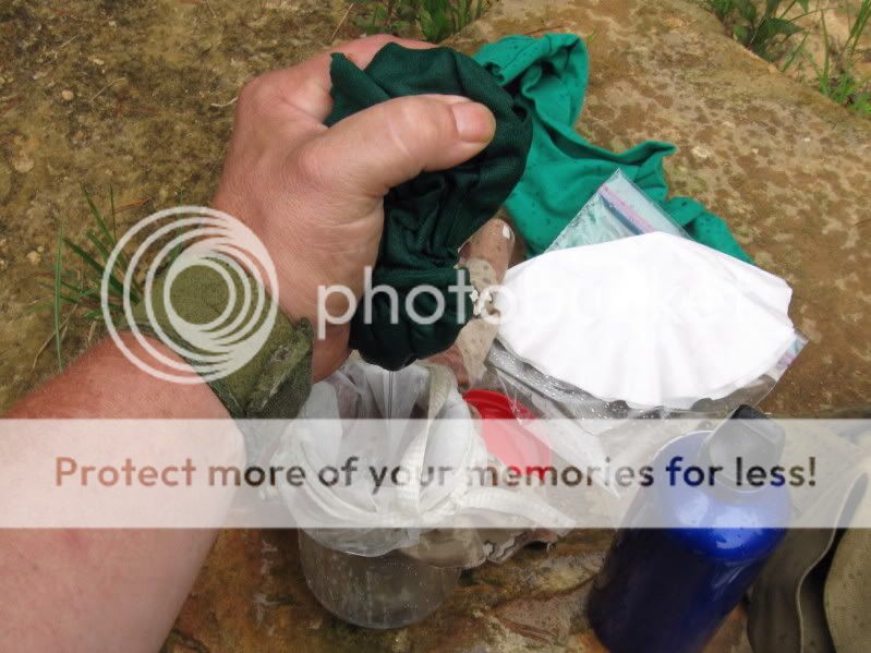

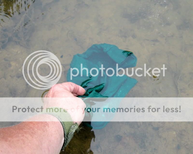

If you do not have a zip lock or another container a piece of cloth (needs to have been washed enough times that no dye rinses out in this process) can be used to soak up water like a sponge....
...and then wring it out over collection bottle. Now the water is ready for purification. This is also a good way to extend the lifespan of the ceramic filter of a mechanical water filter.
