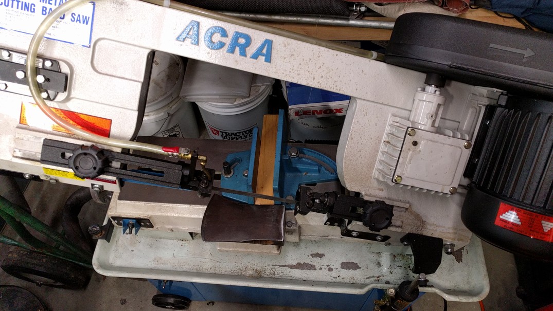

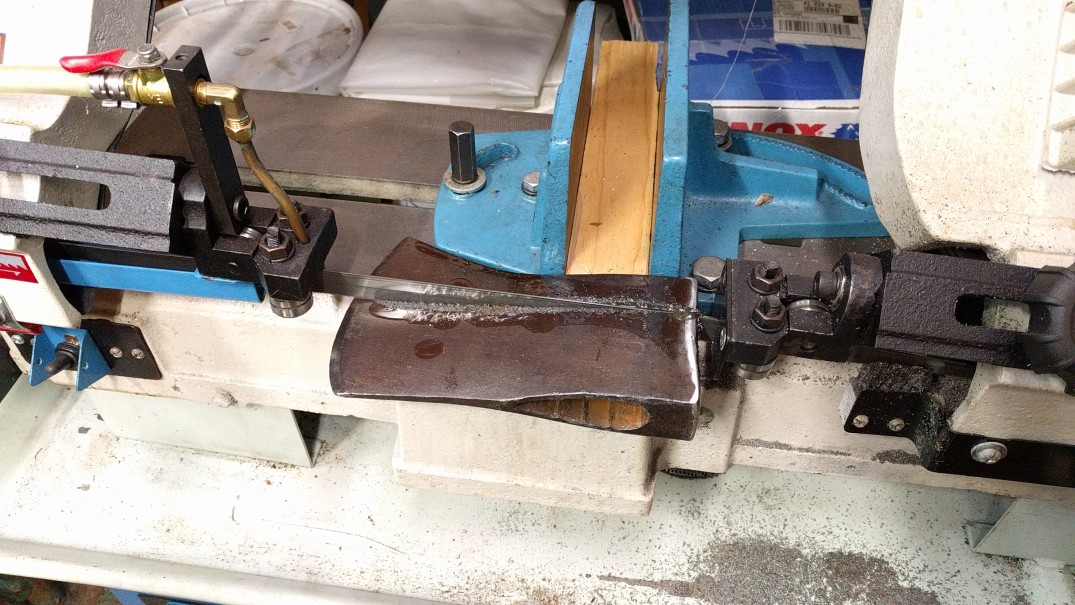

So this happened...

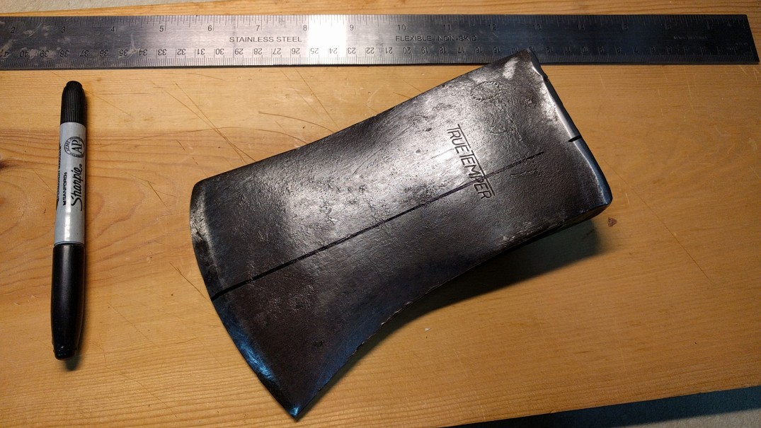

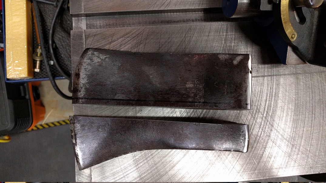

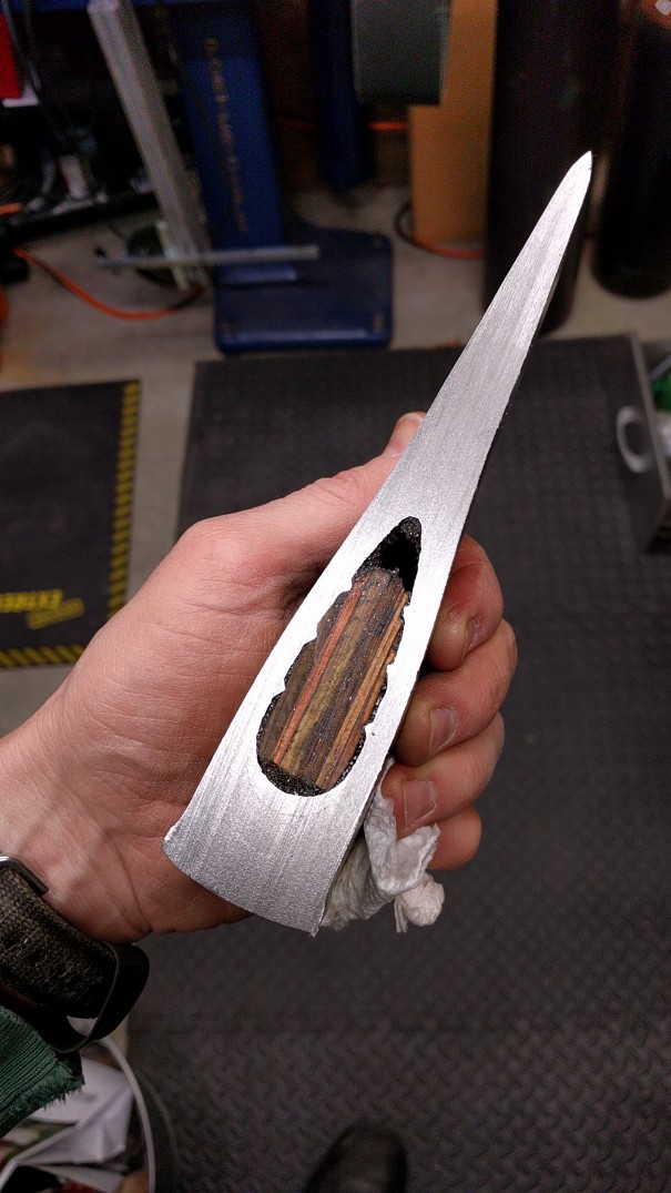

I had this not-very-interesting TrueTemper-stamped 3.75lb axe with a ribbed eye. This evening I got a wild hair, and decided to setup the idle bandsaw in the basement. Now I need to find a haft to start from. This is the 1.25lb result of the evening's shenanigans:
WTH, can't edit this post to fix top image links...
ok, that's better. Silly editor is too smart for its own good. Or my own good...
You certainly sliced that True Temper pole to bit.
I am drinking coffee in front of the fire after a little snow shovelling, I come in and, well.
When I get a hair across my arse I usually yell something regrettable and then go swing an axe not slice one...but that's me :D
You certainly expose a great part of the axe that is most interesting to see and examine.
Let's see what you have done this morning with the project.

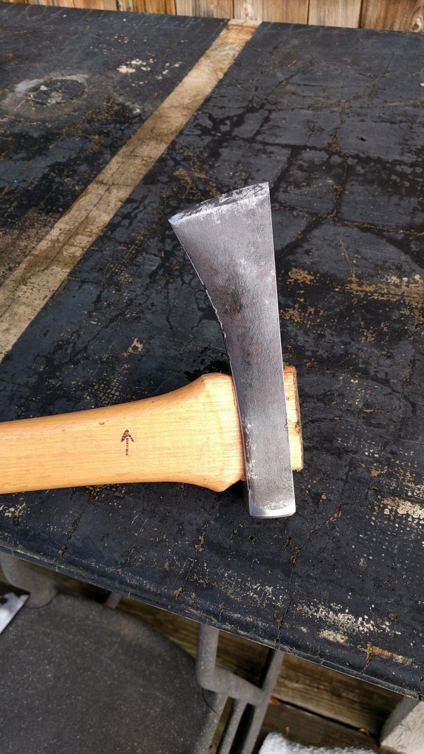

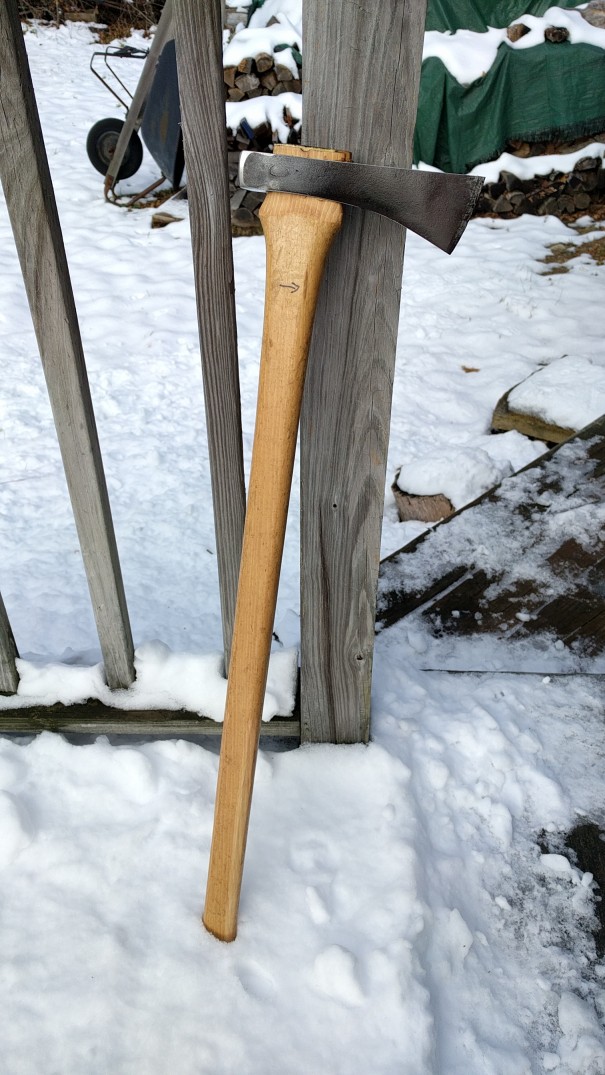

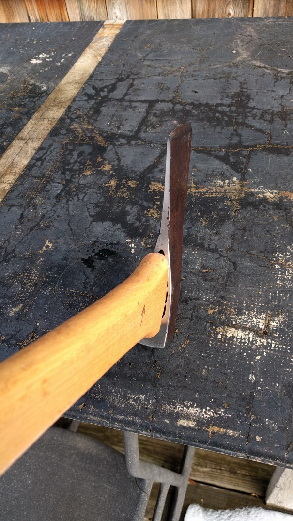

Here's the so-far set of pictures.
The haft needs to be rounded a bit and the eye is obviously a little large for this scale of head. I left the wedge crude for the moment, in case I mess with it. But it's almost the right height, and holding onto the head like cane works pretty well. If I proceed along these lines, I'll make a cover that goes over the wedge and everything.
imagine using it waking down the mountain .... I think it is too short
I agree, actually. It's fine for going up. :-/
A full 48" would be better. This was the longest, straightest tool handle I could find. Starting from a bare board would give me more options, but that's a larger undertaking. This haft was $2.50 at the flea market!
