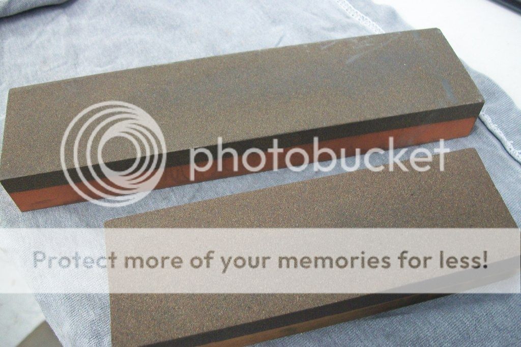

I recently picked up a stone from my father in law that is of a type I've never seen before. Initially it looked like it had a medium Crystalonesque grit on one side and the other almost looked like a fired Alumina barber's hone. Gave a D2 Eskabar a few passes on it for a microbevel and it refined the edge nicely.
Heavily plugged with swarf and oil and visibly dished, I started lapping it and lo and behold the "coarse" side looks more along the lines of the fine side on an ACE combination stone except based on color it is probably AlumOx, the fine side almost looks like a soft Arkansas.
As it cleaned up I notice the surface is too uniform in color and texture to be a natural - has no voids at all and is 100% uniform in color across 2x6". Close inspection of the chipped areas along the edge pretty much confirms to me it is some sort of manufactured AlumOx India stone, but far finer than even the US made Norton India.
I have no idea if this is even a Norton product, but it is a heck of a stone and I'll be sure to lap it completely flat and post up a picture as time allows - it is one tough cookie.

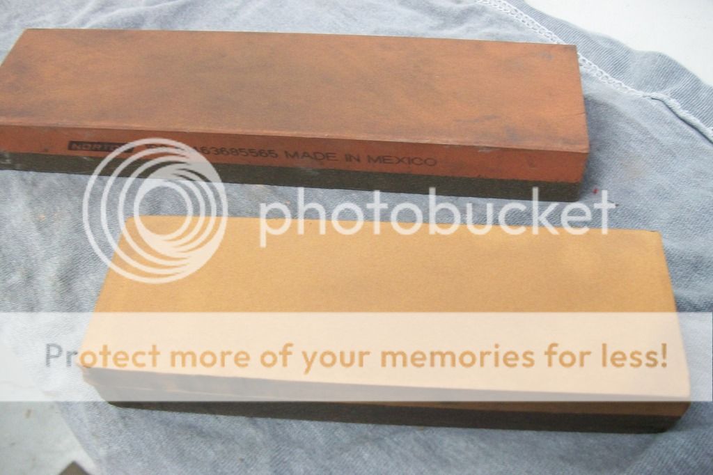

Here's the update to the last post.
I had a chance to try this stone out. Lapping it was just as difficult as the current Mex India stone. The ends of the stone are not clean cut, but that may have been done by the father in law at some point or was cut from a larger stone.
The coarse side looks very similar, the fine side is very different in both color and feel. Also, after extensive lapping on a diamond plate and then conditioning it with loose silicon carbide it still holds thin oil on the surface very well.
Used it to touch up a knife with 1095 steel, it cut fast and clean, removed the burr easily and has that great velvety feedback you want in a medium grit stone. Was able to crosscut fine catalog paper with less hitching and noise than the standard India stone but still very grabby - if the current issue is approx 320 grit, this one is probably 600 and maybe cut like an 800 once broken back in. I wish this were a full sized stone.
I am not certain of the pedigree or vintage, this could be from some other manufacturer but I personally believe it is at least 30 years old, possibly much older.
Pics, the darker larger one is the Mexico Mfg India:
HH, your Father in Law's stone and my fine India are the same color. Only mine is a 1" all India. Not a combo stone. I think mine even has
some inking on the side. I'll look. Thanks for posting this photo as it reminded me to look at mine. DM
HH, your correct on this stone being more dense that the Norton India stone. And it is much finer. I agree with your assessment, on this
stones grit. It feels like around 600. I lapped one side finer and that side acts & feels like around 800. This gives me good grit progression. DM
