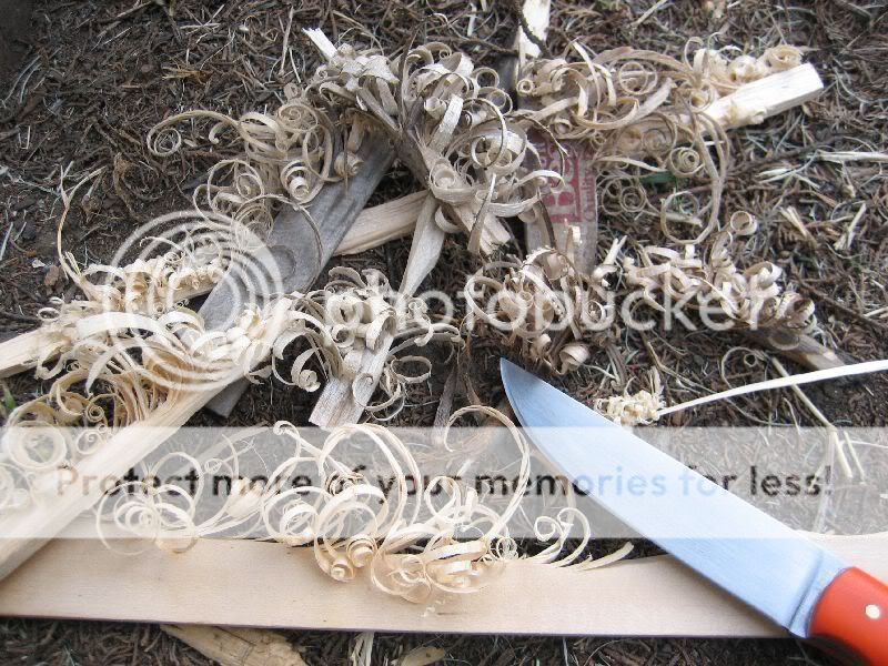

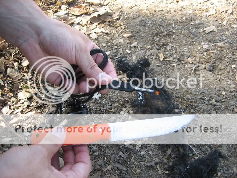

I convexed this Breeden easily and I think its better suited for bushcraft since it isn't as thick as an F1. Around $90

I do like the looks of that Breeden, but for effectively the same price I would rather have the Fallkniven.
