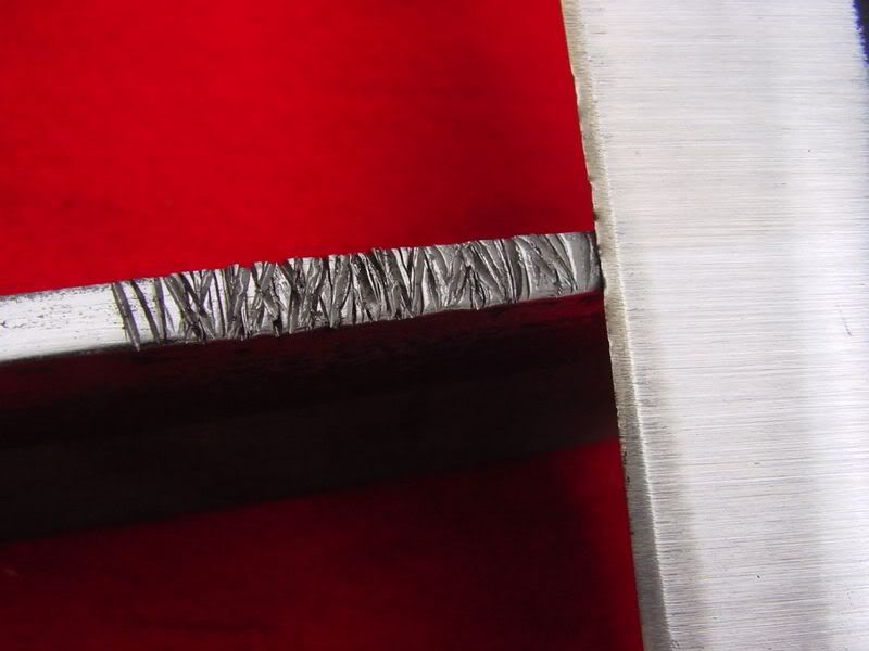

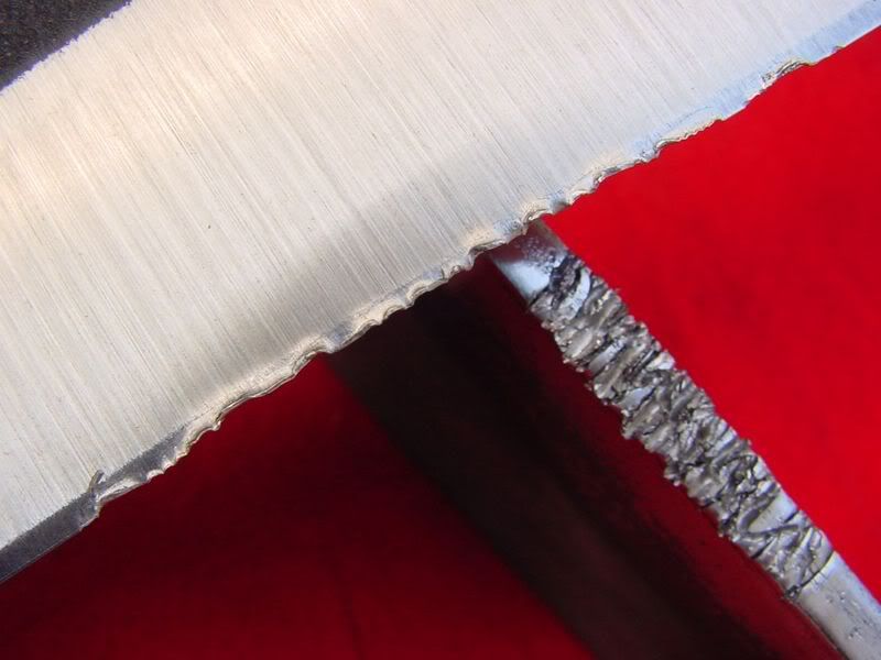

INFI and S7 versus my old bedframe

Having tried to steel lesser damage out of a blade before, I'd say when it's that far gone it's time to just grind it back down. I'd wager that once all the damage is sharpened out it'd fare better against that same bedframe. My infi SS4 and NO-E both had some edge weakness issues with the (thick) factory edge. A good sharpening to remove all the damage and they're performing much better with a much thinner edge.

Not this one. Once you get the 90 degree bend eliminated, it bends and breaks by hand. The expose grain is so large that it's visible to the naked eye. :barf:

The title of this thread probably should've been "Thinner edge verses Thicker edge". . . . Here are some definitive pics of the EXACT same knife made out of SR-77 (It's a Scrap Yard Dog Father heat treated to 59.3 Rc) with 2 slightly different thicknesses behind the edge (The thicker one was .047" prior to sharpening and the thinner one was .030"). Both edges were sharpened to the exact same angle and the knife was set in a fixture on our automatic chopper in order to insure that they impacted the steel at the exact same angle and force. The ever so slightly thicker one faired MUCH better than did the same knife with the thinner geometry. I repeat for clarity purposes that we used the exact same blade for both tests so that there would be absolutely NO discrepancy in hardness or heat-treat. :eek:
The thinner geometry bit in nearly 50% deeper on the initial impacts BEFORE the edge gave up. The Thicker edge sustained far less damage but proved to be a much less efficient chopper on wood than did the thinner edge.
SR-77 is an impressive steel. . . Look closely at the thin edge and note how it dented and tore but never chipped! Very cool!!!
When these same tests are performed with INFI at these same geometries, you see nearly identical results. . . . . Most other steels suffer major fracturing and chipping with nearly irreparable damage to the edge.

Here's the damage to the thicker edge. . . Very impressive!!! (Pic below)
Here's the damage to the thinner edge . . . Ouch!. . .Does not look as impressive. . . but it is!!! (Pic below)
. . . and another shot of the thinner edge. . . Lots of good times ahead for the poor guy who has to resharpen this edge. . . (Pic below)

Just to clarify, the knives were only hitting the edge of the frame, not each other. Both did great and prospered and suffered according to their geometries. The FBM's edge was thinner and better for actual work on this heaven below. The RD-9's edge was thicker to provide me with entertainment (years back, it and a Ratweiler at smacking galvanized fenceposts and the Ratweiler faired better for the same reasons Jerry mentioned). I am not saying knife a is better than knife b or vice versa. One was a custom made just for me (the extended front guard and serrated thumb ramp) and the other was made Muddy (presumably just for me) and they both rise and fall on their own merits as nearly-indestructible knives.
