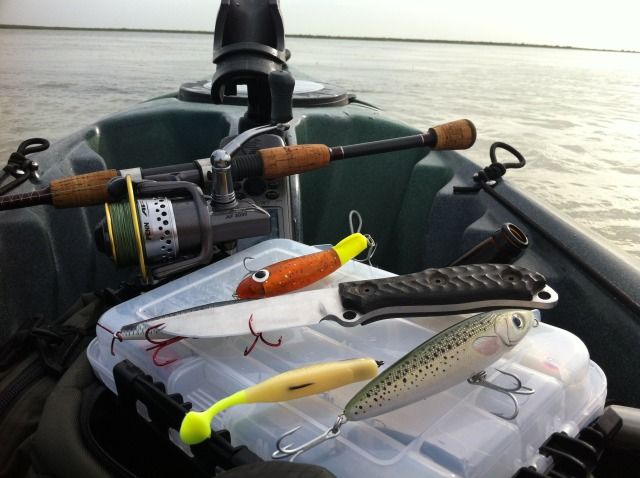

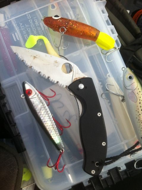

I salt water kayak and wade fish with my meaner. No sweat, ever. No rust, nothing. Compare that to the other knife I had this day. The Tenacious (8Cr13MoV) after several hours exposure...
