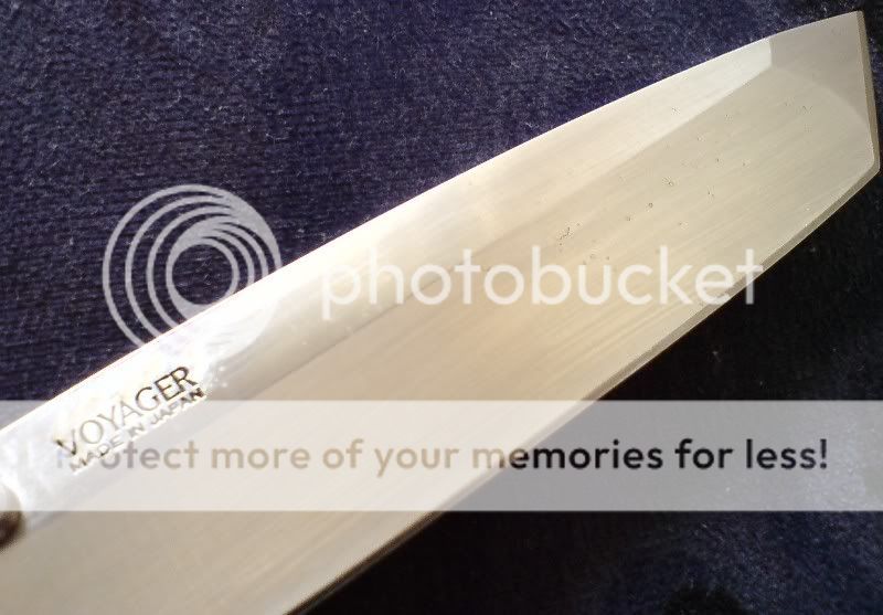

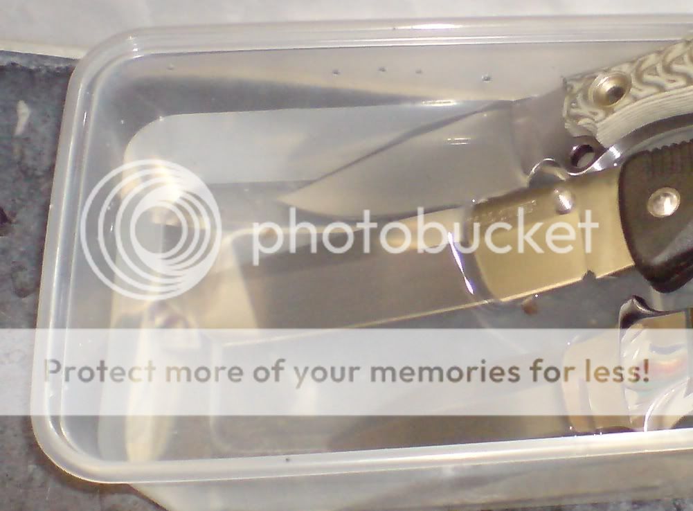

Thank you! In order to prove it with pictures, I did a quick test at home. Sorry for the quality of the pictures! I didn’t have any proper camera with me, so I used my mobile phone.
I took a CS AUS8, one polished S30V custom and my Busse Custom AD and put the blades in a bath of seawater.
I let them sit in the bath for 1 hour. When I checked I could see small spots on the AUS8 and S30V steels- but nothing on the INFI.
I let the knives be in the seawater bath for another 30 min, with a total time of 1-1/2 hours. I then took a paper towel and wiped each blade dry before inspection.
The AUS8 steel had small spots on the blade and the logo got like a brownish cloud around it.

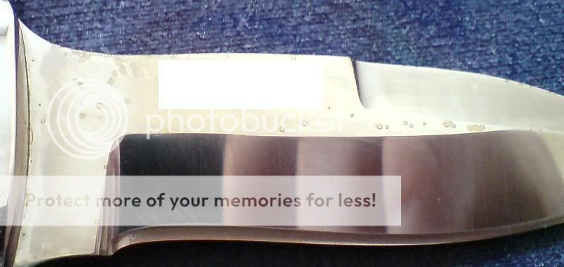

The S30V steel, polished to a mirror image, got plenty of spots all over the blade.

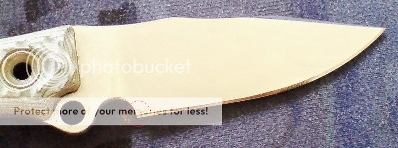

And finally, our dear INFI clearly came out as the clear winner! No patina, no spots- other than one small spot at the edge near the choil (I put a red circle around it). This spot I could remove with my finger nail.
When you go for Scuba diving using normal compressed air, you usually spend 45- 60 minutes under water depending on which depth you are at. If you wipe you INFI dry after a dive- you should never have any problems.
There is no reason at all why you shouldn’t use INFI in or around seawater. This steel has much better corrosion resistance than many stainless steels I have tried.
Long live INFI! Use and abuse your Busse wherever you are!

That is about the extent of rusting that I've experienced with infi as well. I never worried about it, just used it some more and the edge would polish right up. Its good to know that it performs the same in salt water; thanks!
