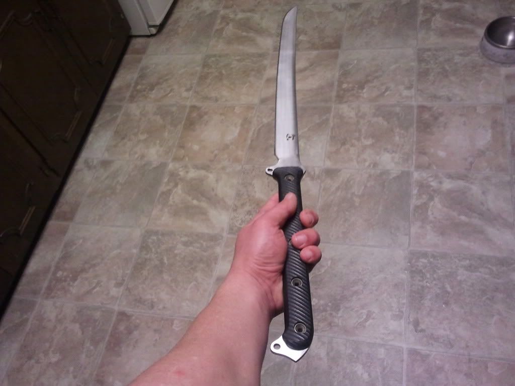

I think my satin AK is my very favorite posession. wouldn't change a thing except maybe the handle colors.
