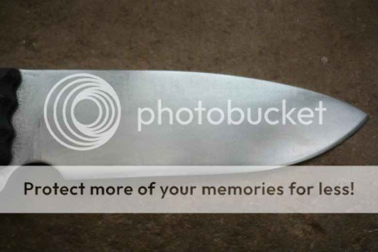

After experimenting with Infi for a few years now my sharpest edge comes from thinning down the flat grind on a knife and then taking a fairly high tapering convex edge like this ...
This is perhaps my sharpest Busse and I doubt any sabre grind blade would improve on it for slicing .... a thin fully convex Skinny Ash is close ....

ok, i think i am beginning to understand now. The top pic, is that full convex?
Oh, and WHY do SOME people LIKE saber grinds?
The top pic is a flat V grind but the edge is a curved convex appleseed shape ....
