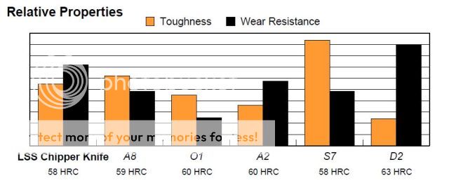

They are not going to tell you that. Many folks think that is something akin to a modified S series steel with nitrogen added.
Someone had Infi zapped (X-ray diffraction) awhile ago, and it's within a decimal point of LaTrobe's A8 Chipper Steel (A.K.A. A8 Modified).
A great, tough alloy steel with a blunt cutting geometry == broken cinder blocks :)
http://www.latrobesteel.com/assets/documents/datasheets/LSS_Chipper.pdf
http://i164.photobucket.com/albums/u15/rtgeorge_album/Infi.jpg
INFI's composition has been known to the public for nearly 10 years. It's not a modified A8. Given the degree of difference in number of elements present and percentage of those differing elements: they look nothing alike.

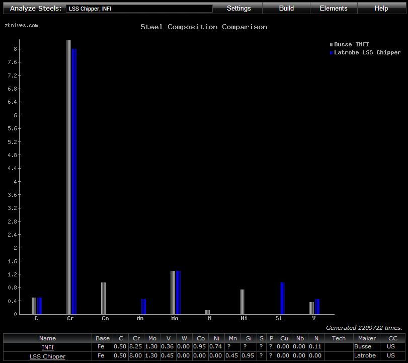

That's because you have the wrong steel. Try comparing Latrobe's A8 Chipper steel to INFI:
http://i164.photobucket.com/albums/u15/rtgeorge_album/Infi-1.jpg
There are similarities and significant differences. 1%cobalt, nearly 1% nickle, .5% manganese and 1% silicon create a notably different alloy. My next question is when did LSS chipper steel come into existence? The pdf from latrobe is dated 2006, but Timken sold Latrobe in 2006 so it may just be that they updated all of their materials. I ask this because INFI has been present as a production steel since 1998 when busse produced the 60rc SHBM's, one of which was reviewed by hood in 'american survival guide'. Chances are it was in existence before then for testing, but the SHBM's were production models.
If latrobes LSS chipper steel came out later than INFI, how is INFI a modified LSS chipper? would it not be the other way around? Or at the very least, A8 being modified to be similar to INFI.
