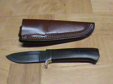

I have a friend in Canada that owns this knife
Apparently it was made in the 60's
What can you tell me about this maker

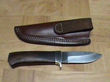

STeven just posted similar information, but here is what I have. I bought one off E-Bay a few years ago. May have to search for the photo, or pull the knife out, but here is the info I received:
"This auction is for a really Awesome Scarce 1991 A.G.Russell Morseth Semi Skinner Model Custom Knife made by Custom Knife Maker Giant Bob Dozier. This is one of two (2) or three (3) Morseth knives I am listing this week. Please take the time to check them out. Dozier was hired to create the very earliest Russell Morseth knives and then came back in the later part of the 80's again. I have collected these for years and they are as nice a custom knife for the money as any piece made. Great quality, materials, workmanship, and the world famous laminated steel blades that made Harry Morseth famous. This Semi Skinner Model came out around 1990/1991 as another great pattern to the Morseth arsenal and wasn't offered that long. Amazing in the hand feel. Full tang construction with the retaining nut countersunk into the butt of the handle, one of the soundest most secure forms of construction ever used. The knife was handled by the original owner but was never used with the original edge. Light handling scratches here and there on the 3 5/8" semi skinner blade as well as a few very small nicks to the top of the blade as well. A few handling scratches to the beautiful Cocobolo handle and scratches to the wide Nickel Silver guard mostly from the sheath. This type of guard was only used on a few of the Morseth patterns that were introduced around 1990. Super top grain leather sheath in almost mint condition. You don't see this Model for sale very often. Great piece!! Thank you and good luck. Please email with any questions."
- Joe
As stated, this is a later Morseth made knife with Bob Dozier as the maker, but it gives you a look at the style.
- Joe
