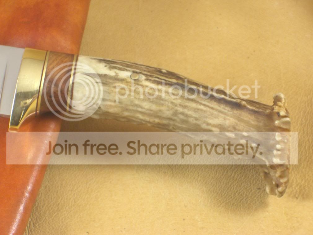

The first pictures in a crown where the guard in about 1/8" smaller than the diameter of the crown, this give me some stag to remove to match to the guard.

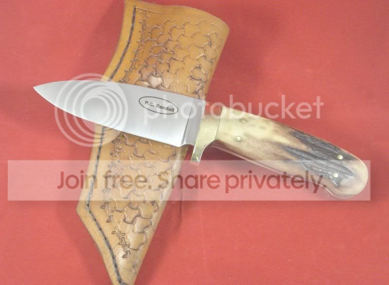

This is slabs with a little more removed, this allowed for the smooth section to move back a bit while still maintaining some of the outter roughness, this is tough to do unless you have a really large piece.
