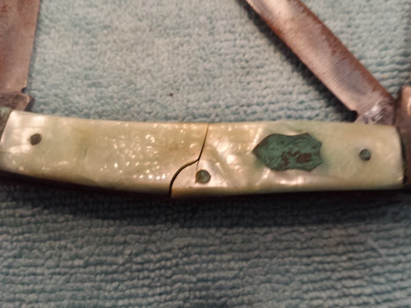

It appears that one of the celluloid handled knives (with the cracked scales) might be outgassing. This might affect the knives which are stored in its closed proximity too.
Store the celluloid handled knives separate from the rest, and even separate from each other.
Inspect them regularly and look for the telltale sign of corrosion of the exposed part of the blades (the blade portion sticking above the handles when the knife is closed).
Thanks, I didn't know anything about the celluloid issues. I just read all about it. Should I just throw that one away? It is in pretty bad shape?

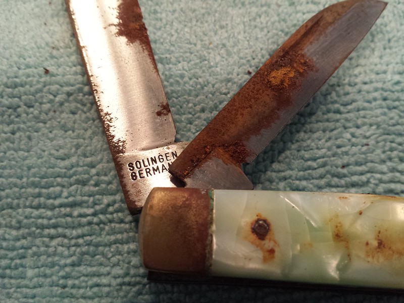

Could you, please, post a better picture of this knife?
Once we see the details, the members here can provide you with a proper evaluation regarding the condition of the knife and a suggestion what to do with it.
Absolutely! I'll take some more pictures of it later today or tonight.
Good call on that one, littleknife. It definitely looks like classic outgassing damage.
You don't have to throw it away, but don't keep it anywhere near those other knives. I couldn't tell from the pics what the stamp was, but in that condition, it's probably not going to have anything other than sentimental value. If it's a good brand, maybe you could have a rehandle done and carry it as a user.

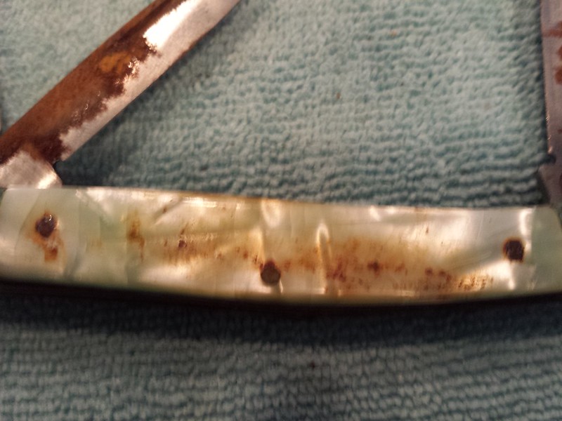

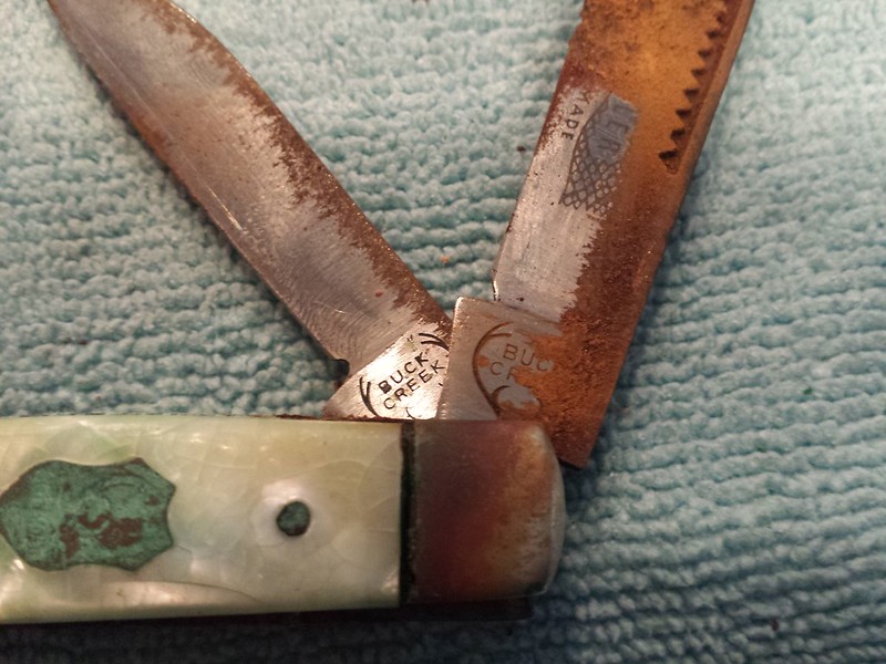

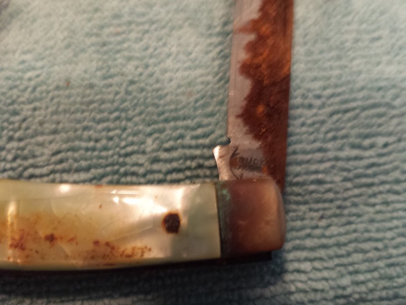

Here's the pictures:

I don't know what other advise you'll get, but I'd take the scales off that one and then clean everything else in an ultrasound tank with something to neutrilize the rust. It's not pitted too badly and can be cleaned up; with new scales it would last another 50 years easy.
