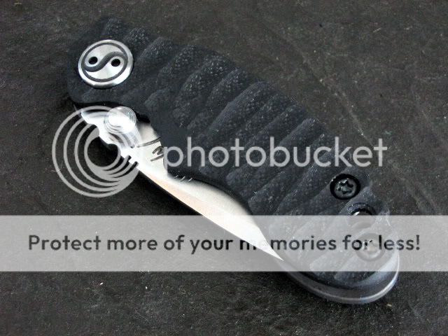

Handle: Black, scalloped g10 and titanium on the other
Pivot : Hardened 440C in Yin-Yang style.

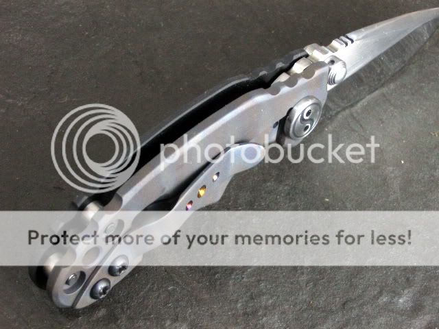

Overall, I found the fit and finish to be very good. The only imperfection on the knife it the blade is not quite perfectly centered. Very close but a tiny bit off. This kind of stuff always kind of bugs me, and I know it bugs other people as well so I think it needs to be mentioned. Other than this, the knife is beautifully done. The blade is nicely polished and looks great. The Titanium slab has a beadblast/anodized finish like on some striders and looks fantastic. It also feels very nice in the hand. The pivot screw is really cool and is a nice touch. The lanyard hole is also nicely placed and I have added a leather lanyard that help makes the knife seem a little larger (not shown in picture). The blade also easily flicks open and the action is very smooth. Lock up is at exactly 25%. 7/10

For such a small knife, I found the grip to be excellent. The finger grooves are placed perfectly and feel very comfortable. The scalloped scales are also very comfortable and grippy. The clip is also comfortable in the hand. The jimping on the knife is also rough, but not sharp and is quite functional. By far the most comfortable small knife I have ever handled 10/10

The pocket clip is titanium and has a finish much like the rest of the titanium slab. The only difference is the colored little drill holes. The clip has great tension. Tight, but not overly tight. The knife rides fairly high in the pocket and this makes it easy to grab but is visible. Personally, never been a problem for me, but if you like a low riding knife, the yuna probably isnt for you. I really like the clip. The only knife I have owned that had a better clip is my sebenza.

The yuna is a framelock and much like the sebenza and other framelocks,it uses the pocket clip to help prevent the lockbar from over extending. It lacks the hinderer stabilizer (I think thats what its called
) but if you look closely youll notice that the unique pivot screw actually extends over the lock bar. This effectivly prevents the lockbar from over extending. I actually did not realize this before buying the knife and at first saw it as a flaw. Very cool :thumbup:
