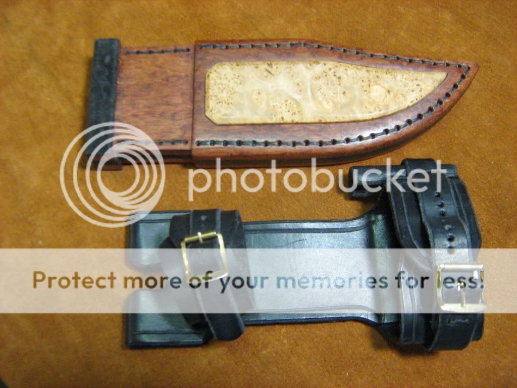

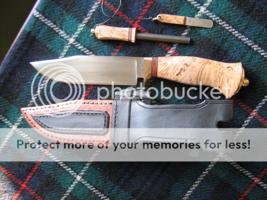

This is a sheath I just finished for a large bowie.

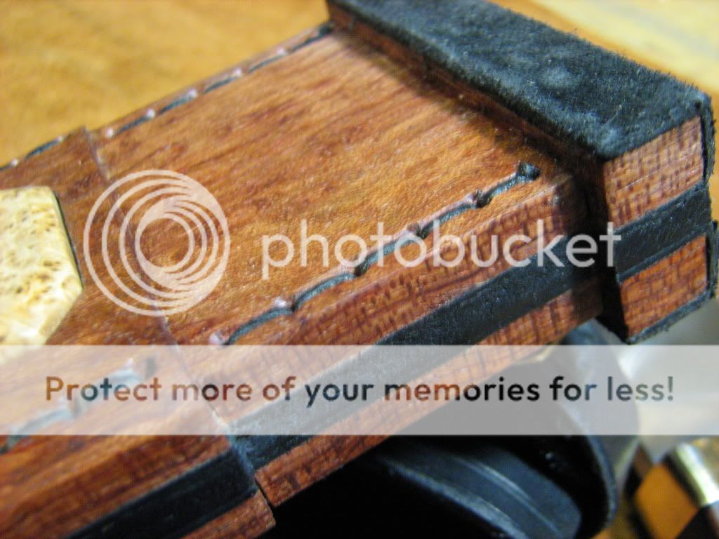

The slabs are of "Waterfall Bubinga.
The inlay on the front is Yellow Birch root burl.

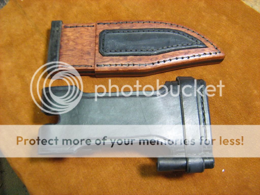

The inlay in the back is a leather wear pad also stitched in.
It has a full leather welt sanded down to get a perfect, snug grip on the blade.
The full lining is of pig skin suede dyed black.

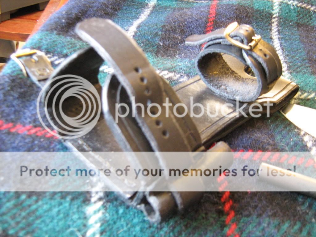

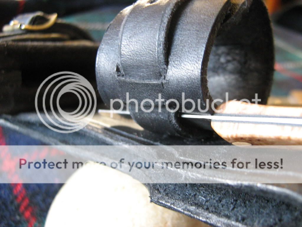

The leather harness-belt loop is 5oz veg tan wet formed and dyed black.
Straps are 3oz veg tan with solid brass buckles.
The stitching is waxed nylon thread in pre-drilled 1/16 and 3/32 holes.
The leather is finished with Bear Grease, then buffed.
The wood is finished with tung oil and furniture paste wax, then buffed.
Thanks for looking.
