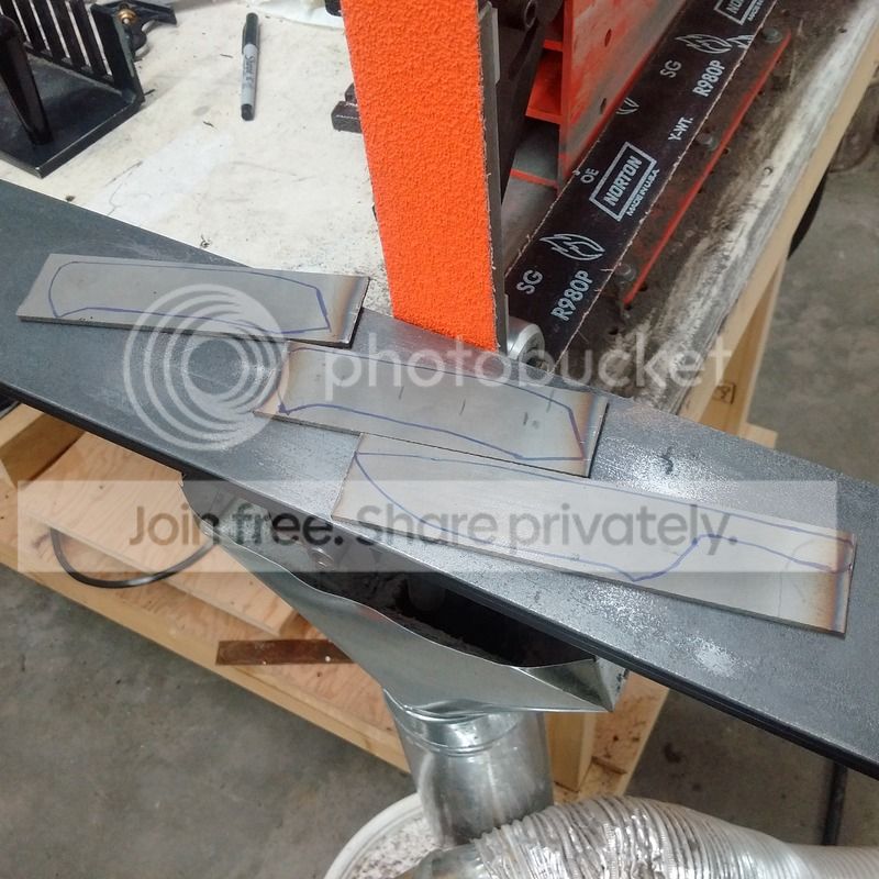

I just got a big slab of mild steel, cut it to the shape I wanted, and clamped it to the existing tool rest. Checked with a level and its good to go. Done.

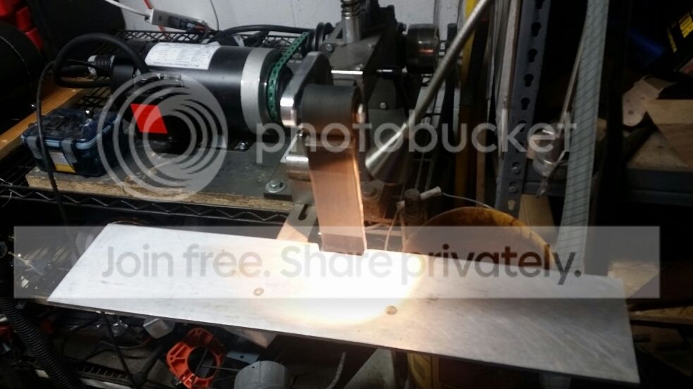

I wanted a larger tool rest for my Esteem grinder. I used 1/2" thick 3" aluminum plate. I took the two bolts out if the stock rest. I laid the stock rest on the new one and used a transfer punch to mark the holes. Drilled the holes on the mill and used a 82deg counter bore to recess the Allen bolts. Went on easily.

I have a piece of 3/8"x6" mild steel plate that I just clamp to my existing work table when I need a larger surface. When I need a clean surface I just put a couple of strips of painter tape down on the surface. I like the phone book idea, might have to give that a try. I tried gluing a piece of 1/16" teflon down to the table, but it just got dinged up to easily.

Mine might be a little big for some, but it works for me. It's 24" long if I remember right. I grind with a jig.
