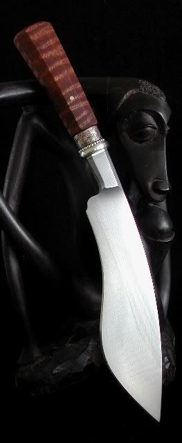

Amazing knife, Tai. Are you edge quenching that W2 and if so, how?
Thanks.....I just stuffed a 3 inch black iron pipe muffle into my propane forge and I have a big W2 bowie that is going to be the first test subject.Yes, It's just geometry, temperature and timing,... and a little luck. I used a muffle furnace to heat the blade, and edge quenched in vegetable oil.![]()
