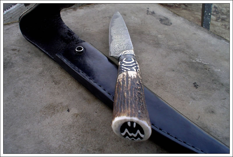

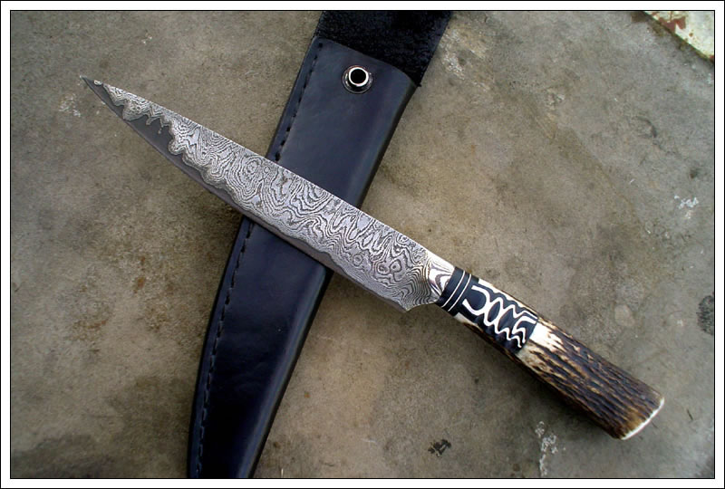

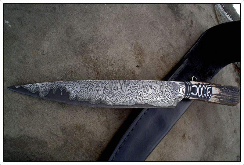

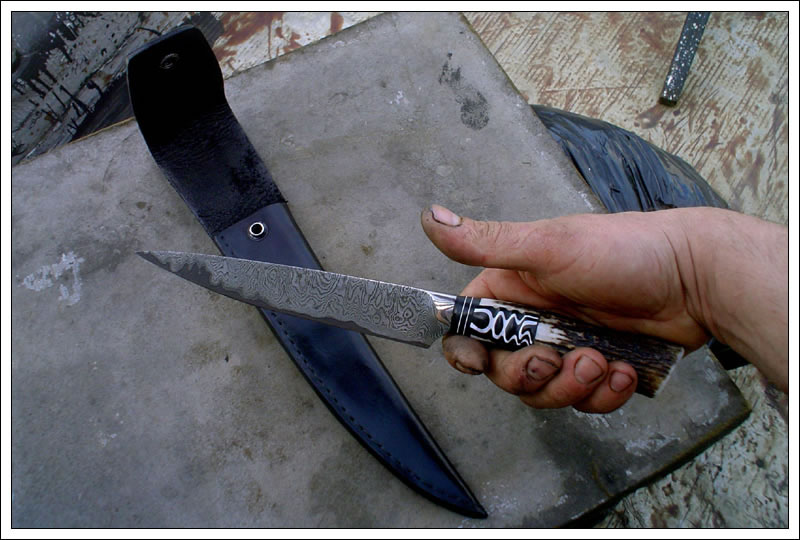

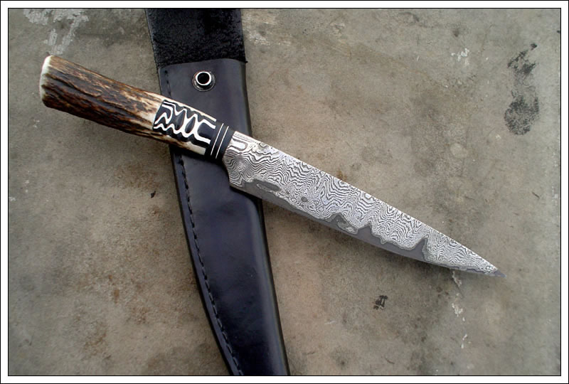

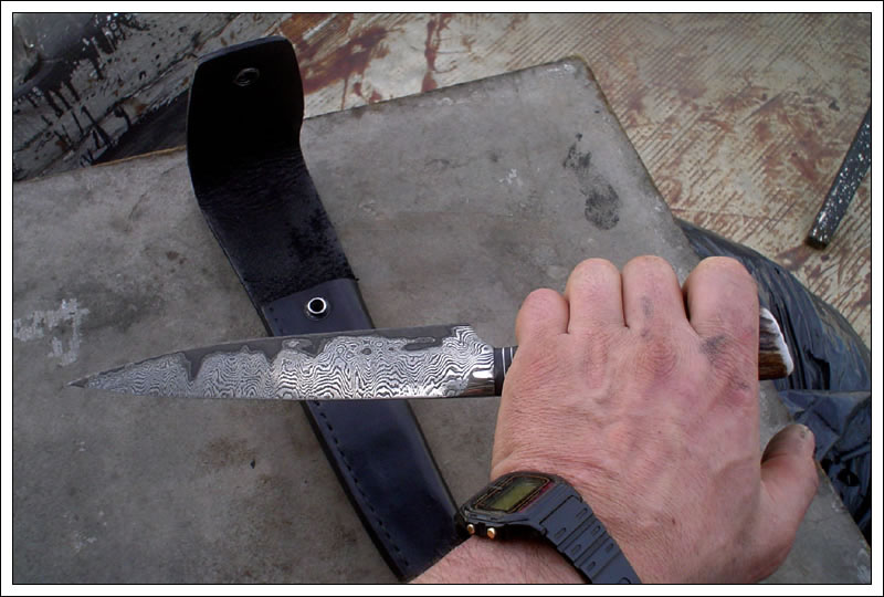

Just finished this for a customer yesterday.
Gerry, if you're reading, contact me as your domain expired and your email address doesn't work anymore
San mai damascus from stainless 304 and 1070 with a 5160 core.
7" cutting edge, 12" overall length. 3/6" thickness.
Stag handles with black / white acetate laminated details and buttcap. G10 and acetate spacers. Hand made leather sheath
