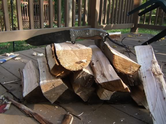

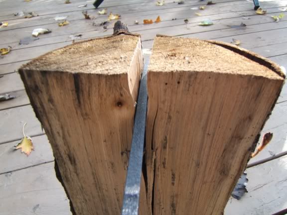

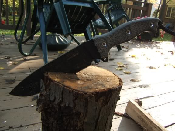

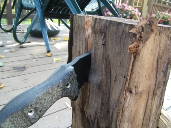

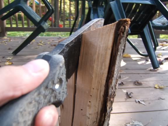

These were all done in a single chop from a HOG FSH. Interestingly (and to my surprise), the EU-17 Magnum could not do this even with the thinned edge. I found that the extra weight from the 5/16s makes a big difference when it comes to chopping and splitting (at least for me). I was really surprised by this because I thought, if anything the extra thickness would put the HOG FSH at a disadvantage for such work. Even with a shorter blade, the HOG FSH still makes a more effective splitting (and chopping) tool than the EU-17 Magnum.
I think the 5/16s *really* gets far into the wood and causes the wood to fall apart. Whereas, the 1/4 (I think) EU-17 Magnum tends to get stuck in the wood far more easily and because of this is less effective.
I just thought this was pretty cool and decided to post it. :D
Why do my pics never show up in the right order? :rolleyes: :o :confused:

Wood splitting profiles tend to be heavy and rather wide to allow lots of power and the ability to violently drive apart the wood. How to the knives chop respectively?

The EU-17 magnum and HOG FSH are really different knives when it comes to chopping and splitting. I have ground the edge on the EU-17 magnum down to around 30 degrees inclusive or so. This knife will now limb branches up to two and a half inches (or so) in diameter in a single chop with no effort. The knife just sails through it. The EU-17 magnum is about 1/4 of an inch thick.
The HOG FSH (which has a NIB blade profile) is made from 5/16s stock. This knife will not limb branches that the EU-17 magnum can. I think that this is because it has a rather thick edge. Batonning (sp?) with this knife is much easier though since the initial chop really splits the wood, the extra blows just push the knife through. Not to mention the HOG FSH does not bind as much as the thinnner EU-17 magnum.
When used to chop larger diameter wood, say eight or so inches or more, the HOG FSH gets much more penetration. I would say this is beacuse of the greater weight and more leverage due to different handle shapes.
