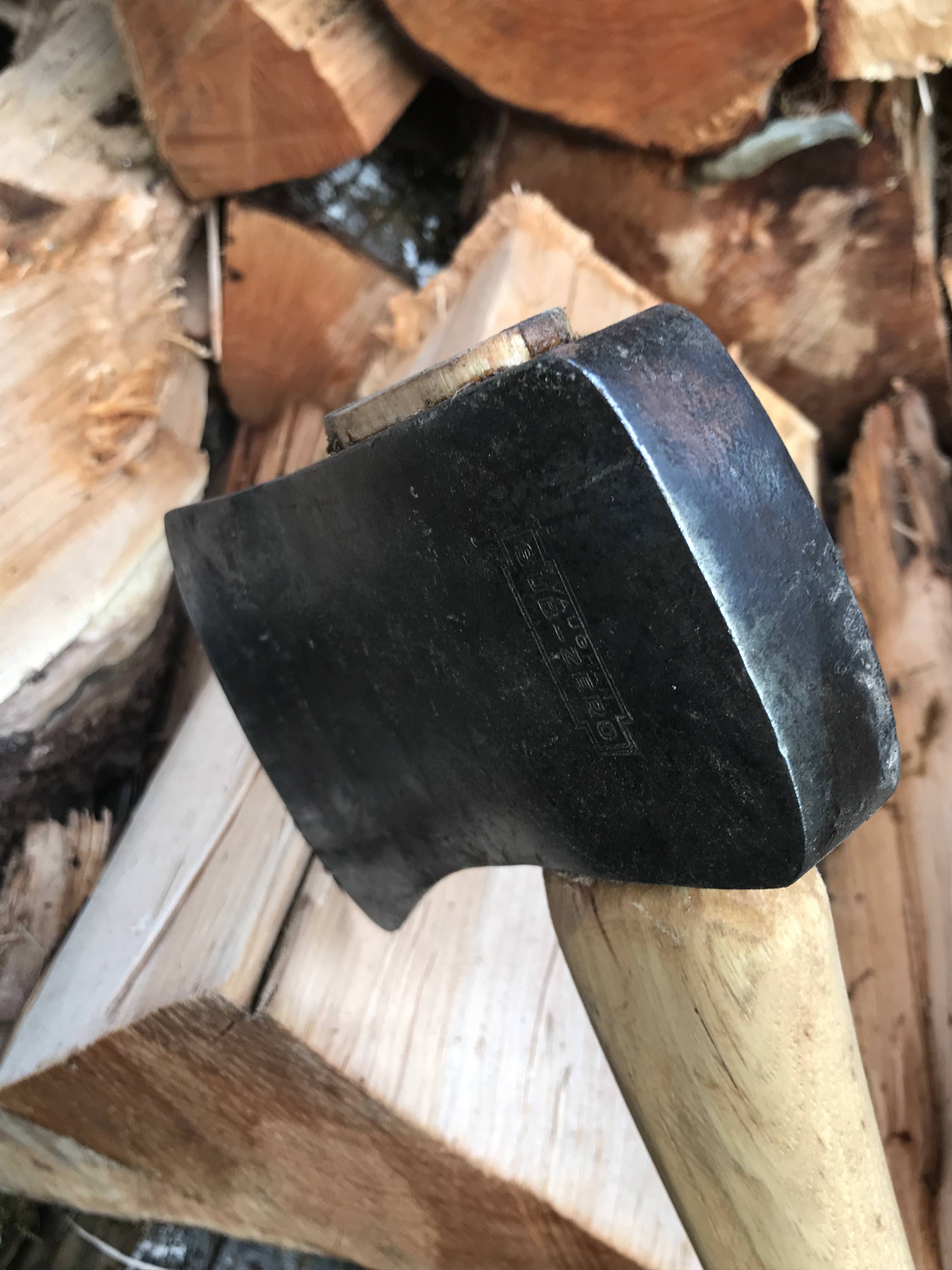

Just wire brushed the rust and crud off this ebay head today.
Craftsman 3^2 and "Hollow Ground"
After cleaning it up I realized only the bit with that stamp was hollow ground the other end is the normal convex high centerline.
Obviously I know it is common practice to have a fine/sharp end and the other less sharp for chopping roots etc.
I had not heard of the grinds being different from the maker to support this method.
Have other makers done this?
I think the interesting part is only one bit is hollow, seems more flat actually

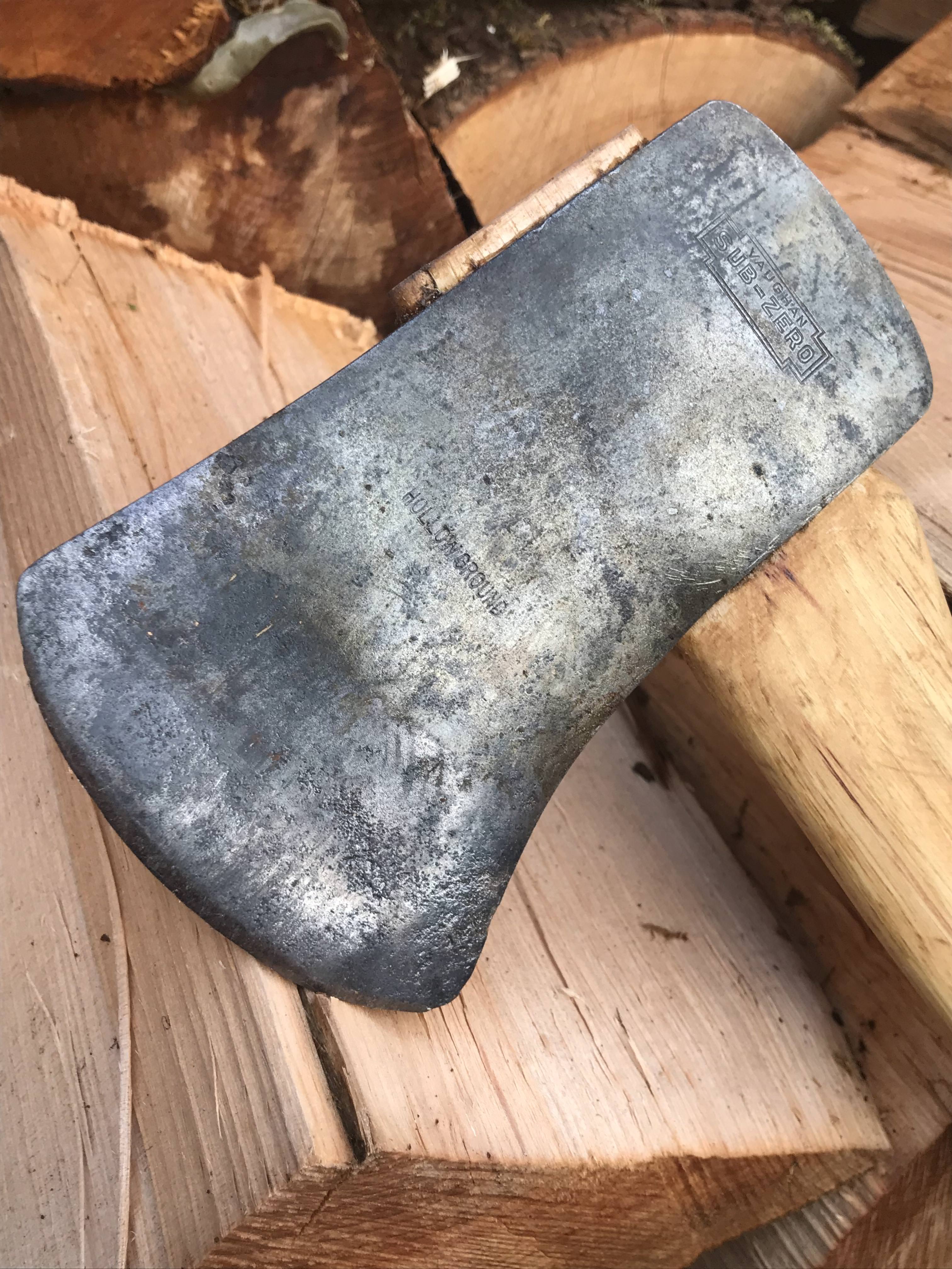

Just cleaned up this Vaughn and wordered how common hollow ground axes are.
Vaughan's online catalog had "hollow ground" axes listed in 2103, 2014, and 2015 (at least). In 2015, they were listed as being IMPORTED.

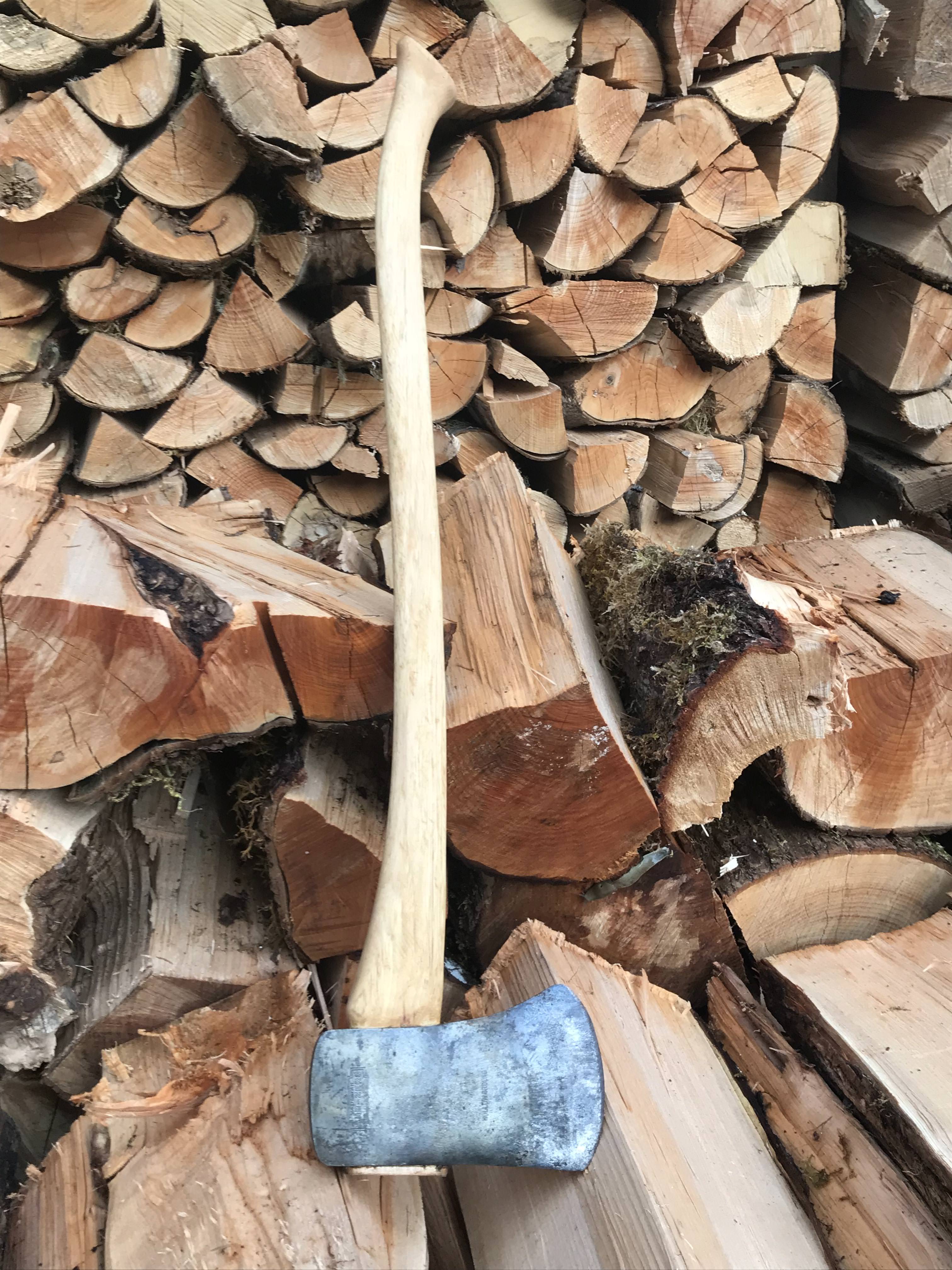

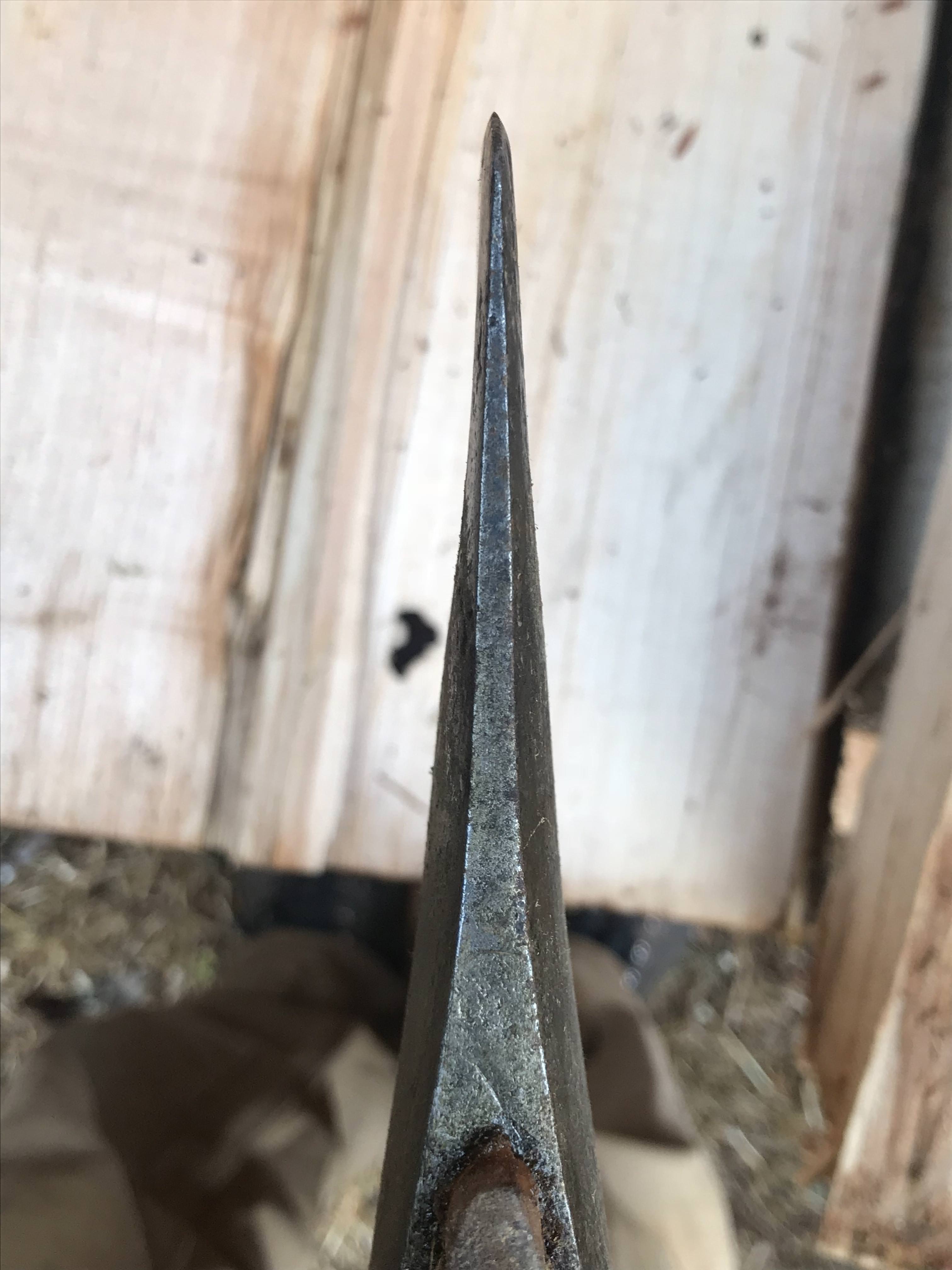

I’ve got your axe’s cousin, a 3.5# single bit Michigan. You can see just how thin the bit gets in the last picture, yet it is very nicely convexed past the hollow ground portion. I can say that it is the WORST splitting axe that I own, which is basically all that I use an axe for. It’s a shame because I am really pleased with the shaping on the handle...
I notice that yours has REG TM under the sub-zero lettering, while mine does not. I wonder if that might help to narrow down a year of manufacture?
