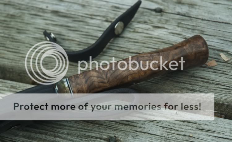

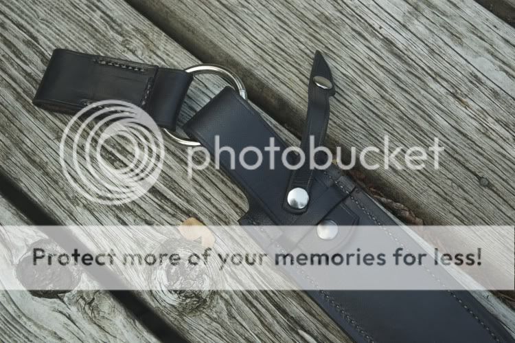

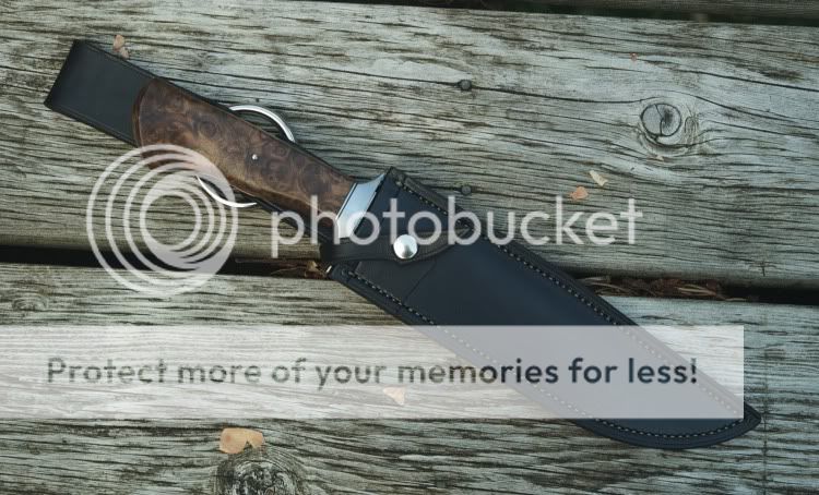

I got a request for a dangler sheath but with the loop removable. Also he wanted the retaining strap removable with snaps..
I'm sure there's other ways to solve this but I kind of like this solution.

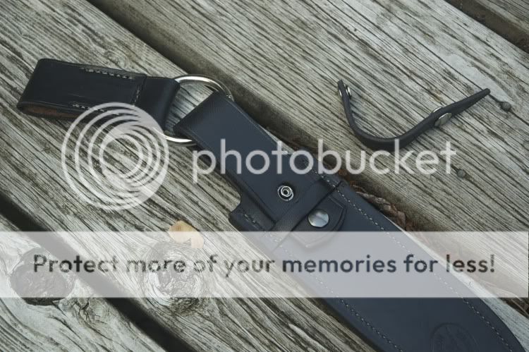

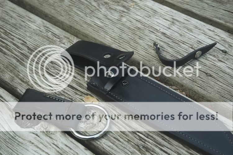

The loop of the dangler is a fixed entity with the ring attached. The photos will show the process of removing it.
I think it's a safe and elegant solution as snaps kind of worry me sometimes.
This way not only allows for the removal of the retaining strap but in this way it is not bulky or in the way of the main loop and actually acts as a second retaining snap for the main belt loop.:D
The little strap on the back makes sure that the main belt loop can't come undone without intention.
It was a head scratcher but I like it.
You'll notice that nowhere on the sheath (inside or out) is the flesh side of the leather showing. (except the dangler loop) I did this by splitting a thin piece so that there is good side out on all surfaces. I like having a splitter.:)
A well thought out solution, my friend. The cross safety strap on the back should insure no accidental loss of the entire sheath. The extra attention of covering all of the exposed flesh side of the leather with top grain is the final mark of excellence, as is the creased edges on the strap work.
