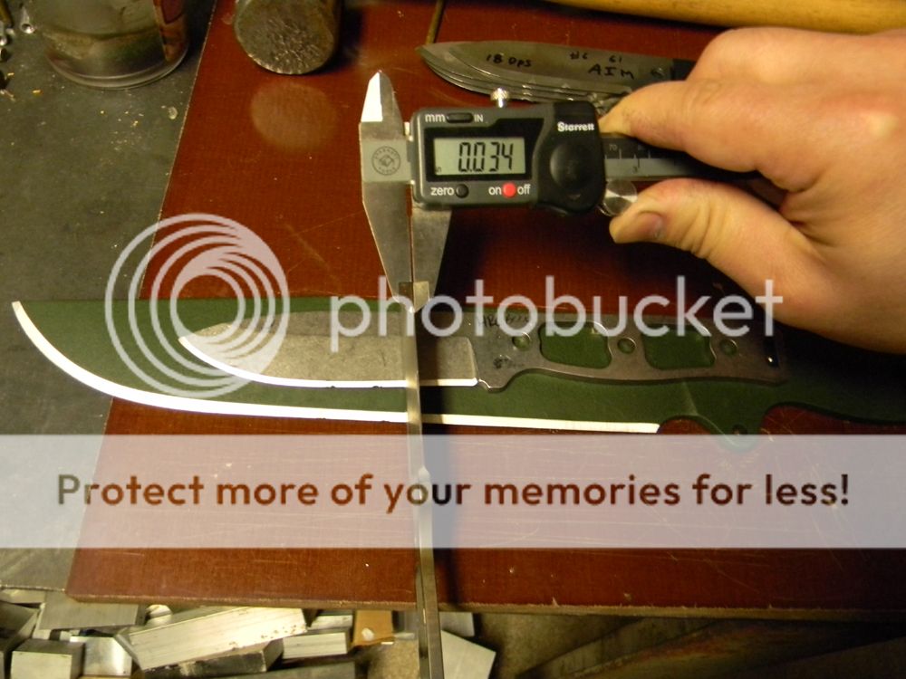

This was a legitimate question and one I set out to answer yesterday.
I'll let Guy tell you folks how I fit into this, but it's worth noting that all of these tests samples are his patterns.
For the development I wanted to see minor changes caused by subtle HT tweaks, so taking primary bevel out of the equation removed a variable. But, I agree, when it came time to actually compare the result to other standards the edge thickness behind the edge could be significant, like you say. I considered that and ran the final protocol in a conventional knife and cut the same nails with it. This one is .034" behind the 18 DPS edge, which is slightly thinner than the control.

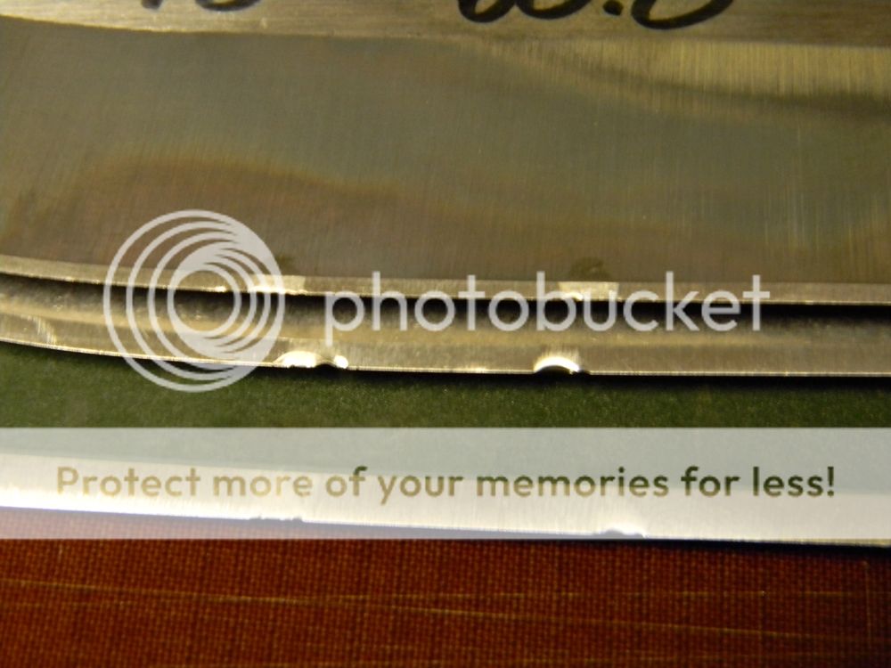

1.jpg~original
2.jpg~original
New protocol run in blade geometry like the industry standard control shown on top. It behaved the same as the other test blade with the same HT. So, while this was a good question, in this case the issue of primary bevel and thickness behind the edge did not effect the result.
The industry standard control blade measured HRC 60. The Busse measured 59. As it is, the new tweak is yielding 60-61. These are all pretty similar measured hardness, with the industry standard in the middle of the range.
And to be clear about bringing a Busse into this. When I was developing a HT for D2 I had a Dozier in the standards. When developing a HT for a large rough use knife it makes since to bring a Busse into the mix of reference standards, INFI is a gold standard for certain attributes. I have nothing but respect for his work.
I's also like to point out that folks need to have some perspective. It's not like the industry standard 3V gave a poor performance here. Take a Buck knife and sharpen it 18 DPS and run it through a 16D nail with a 4 pound hammer and see what happens! Everything is relative.
