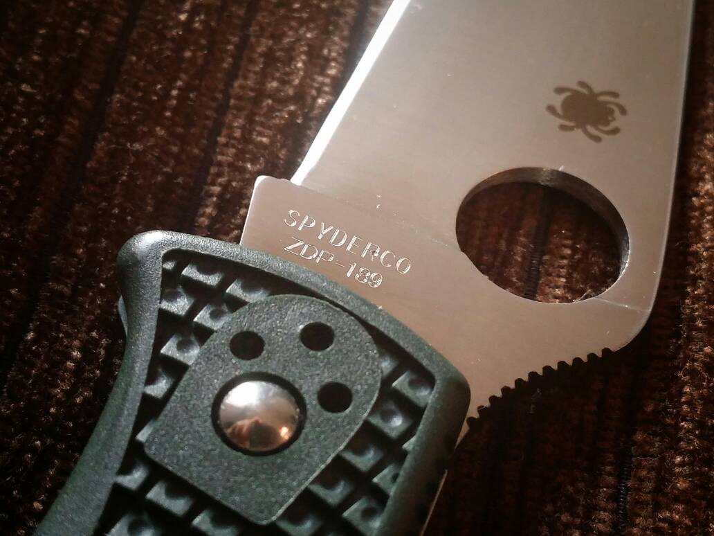

I am a big fan of Spydercos ZDP-189 it is a phenomenal steel at a great price. One if the steels selling points is its high rockwell rating it can take after it has been properly heat treated meaning that it will hold an edge for an exceptionally long time (with the trade off being it is more brittle). The Rockwell on Spydercos is not easy to find for the most part and I was curious as to just how hard Spyderco treated it (Say to Rocksteads 67).
It just so happens that one of my tool and die maker friends has access to a hardness testing machine and offered to test it for me. Turns out it was right at 64.5 rockwell which is part of the reason everyone is getting such good edge retention out of this amazing steel. I look forward to more spyderco offerings in this particular steel!!
Thanks for the info on the Rc measurement on your zdp 189 Delica. i ve always thought Spydercos with zdp steel were great bargains. Particularly the earlier models.
My endura ffg zdp-189 got in measurements 62.5 HRC but the diamond tip of the meter hit the R letter in blade markings. (I think that spot can be a little bit softer due the laser engraving. I did not have a second chance to measure ;(
I own an endura in ZDP-189. One of the best edge holders. But no other knife has ever given me a greater difficulty in Sharpening it. It's Damn hard ! Unless you have access to motorized sharpening equipment.
I wonder I'd Spyderco heat treats different models to different hardness ?
In my totally uneducated and unscientific assessment of my three ZDP Spydercos the laminated Caly 3.5 blade is more prone to micro chipping than my Delica and DF2 .
