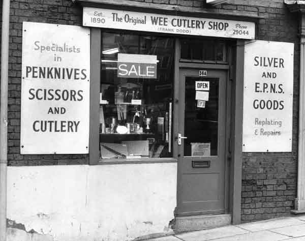

Thank you Barrett. And thanks for posting your picture. I would love to visit that shop someday. Best birthday wishes to Stan!
I'd be honoured to show you around if you're ever able to visit Mike :thumbsup:
The Wee Cutlery Shop was on Howard Street, across the road from the hotel Barrett stayed in. It was run by a lady called Mrs Ashby, and was close to many of the old Sheffield cutlery firms, including Slaters and Wade & Butcher, as well as Arthur Wright. I think it closed down in the early 1980's. Cutlery shops were plentiful in those days, and I don't think I ever actually went in.
