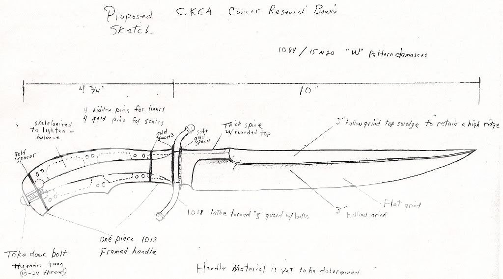

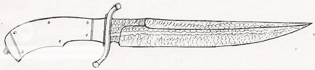

Here's a look at Bruce's drawings of our 2011 Cancer Research Benefit Knife.
I'm sure he will be along to give more details as the creation of our Bowie and Sheath progressives over the coming months.

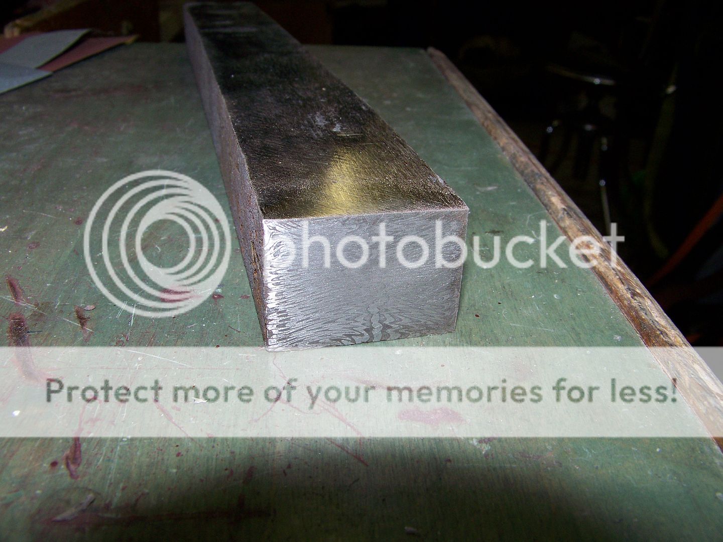

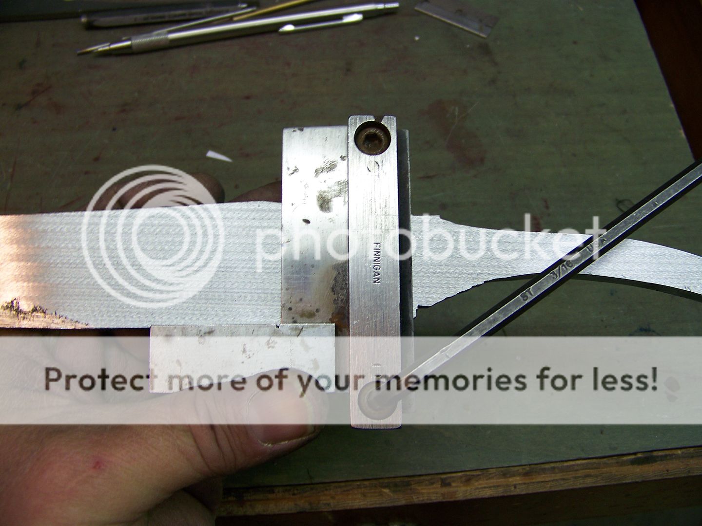

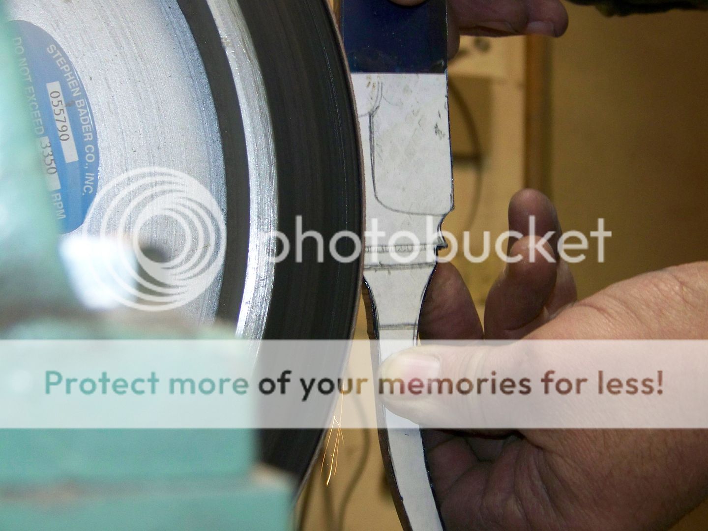

Here is the "W" patterned bar I made for this one. I decided not to show the entire process to get this far because it the exact same as the feathered pattern with the exception of slicing the stack in half and rewelding the two halves to make feather damascus.
This bar is cut at 30 degree angles and each piece is numbered to go back in order. This will keep the pattern more uniform than simply mix and matching them.
Here is a quick shot of the pattern with just a light etch in ferric cloride. I like it.

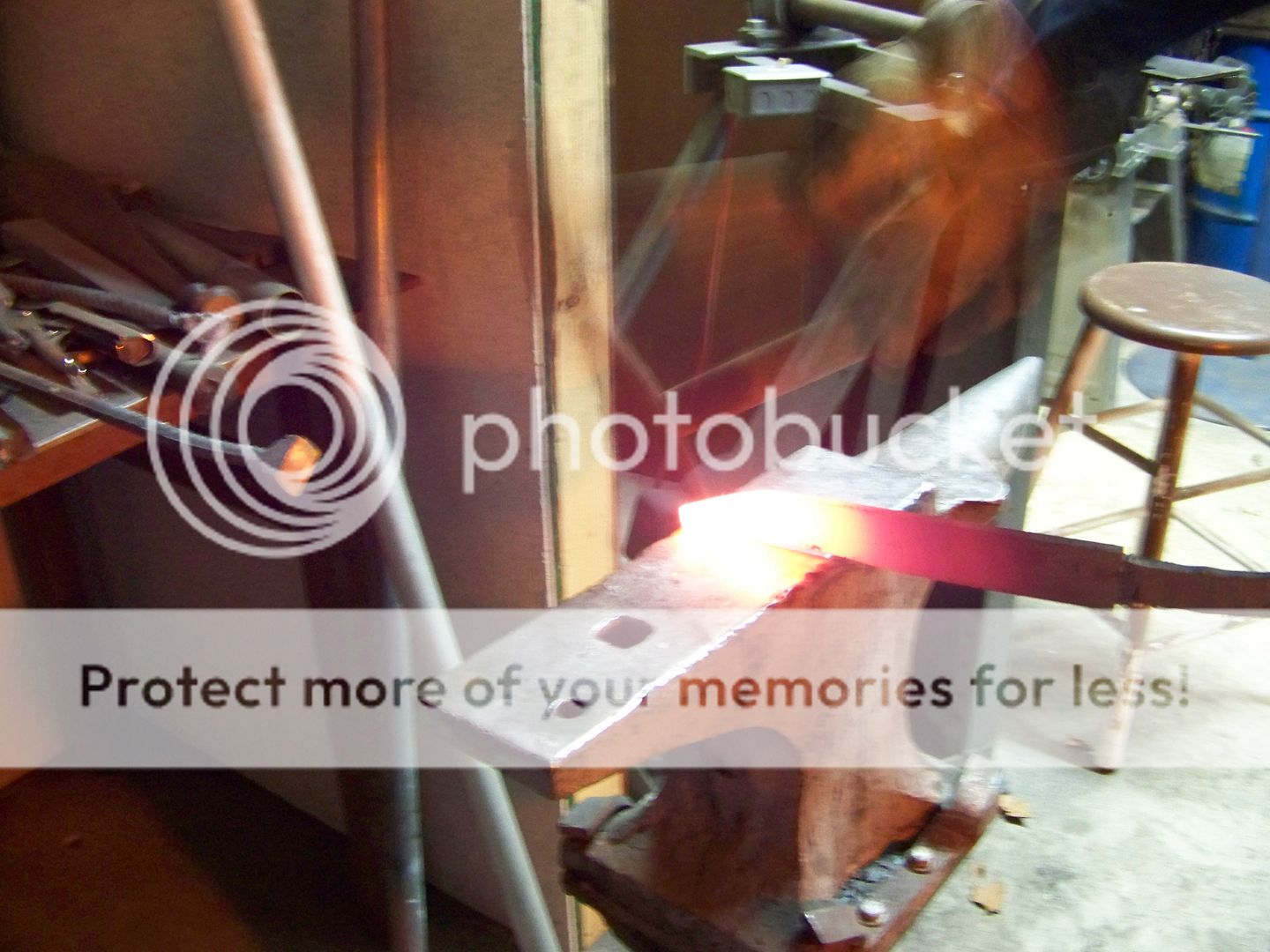

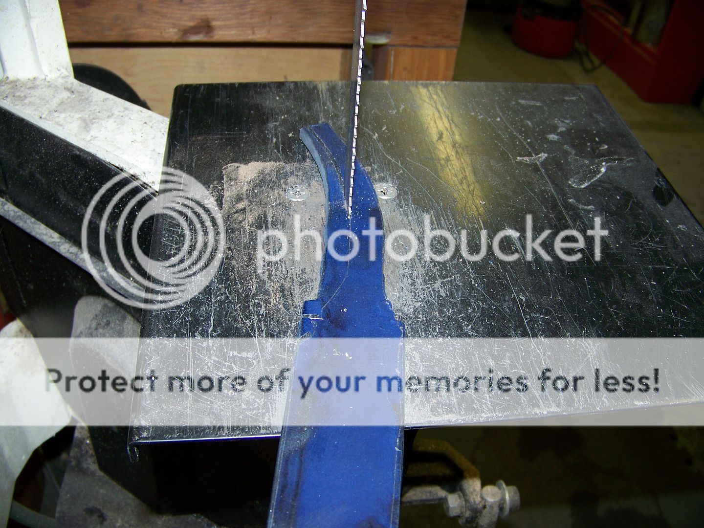

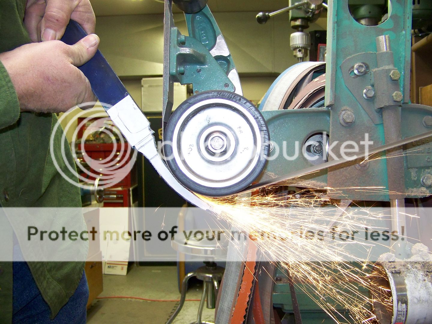

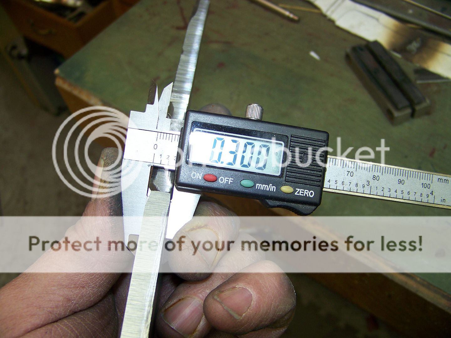

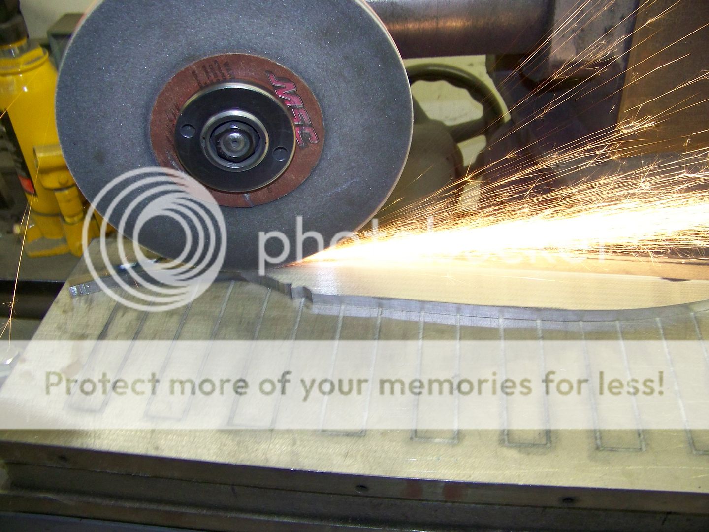

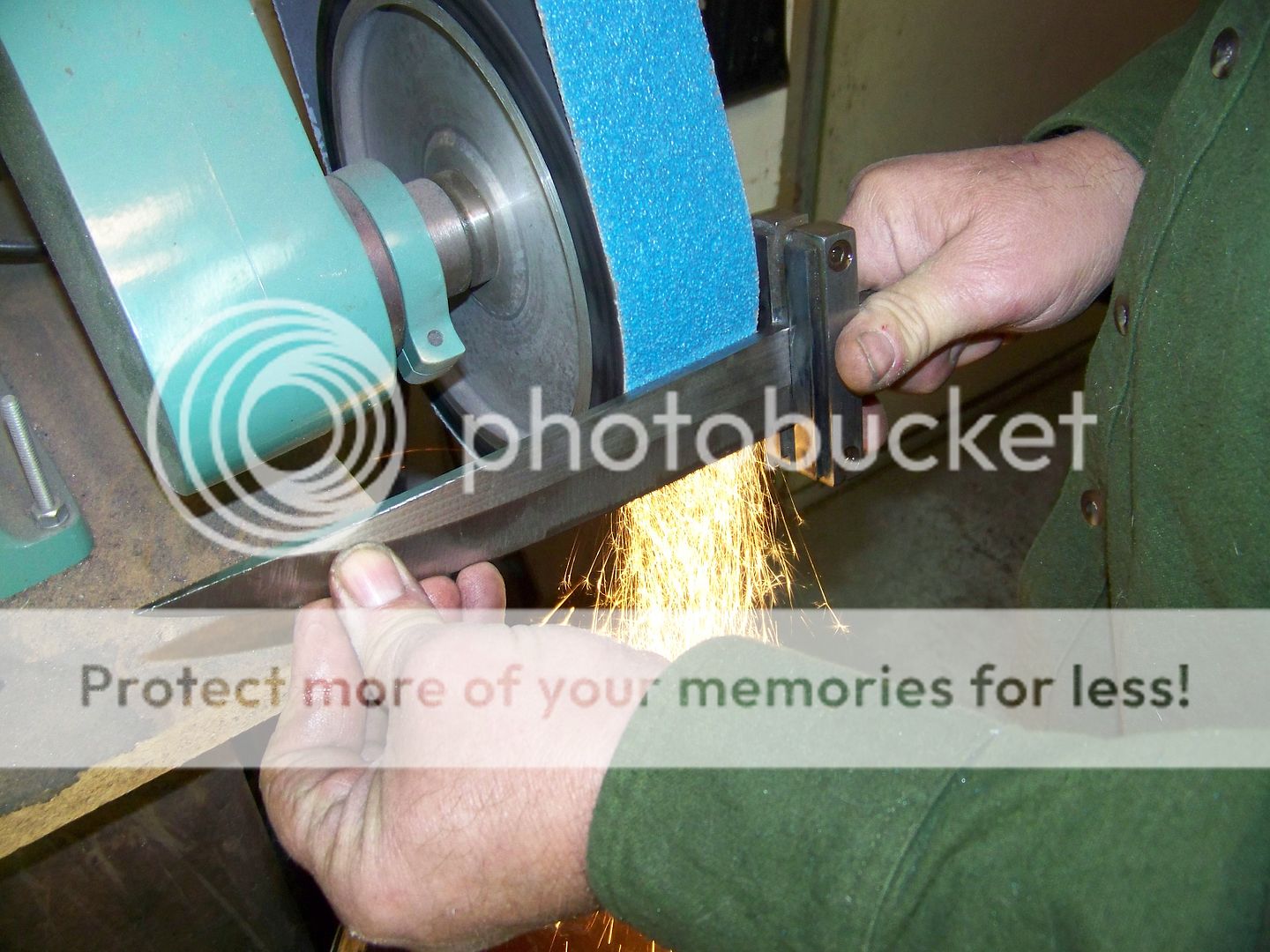

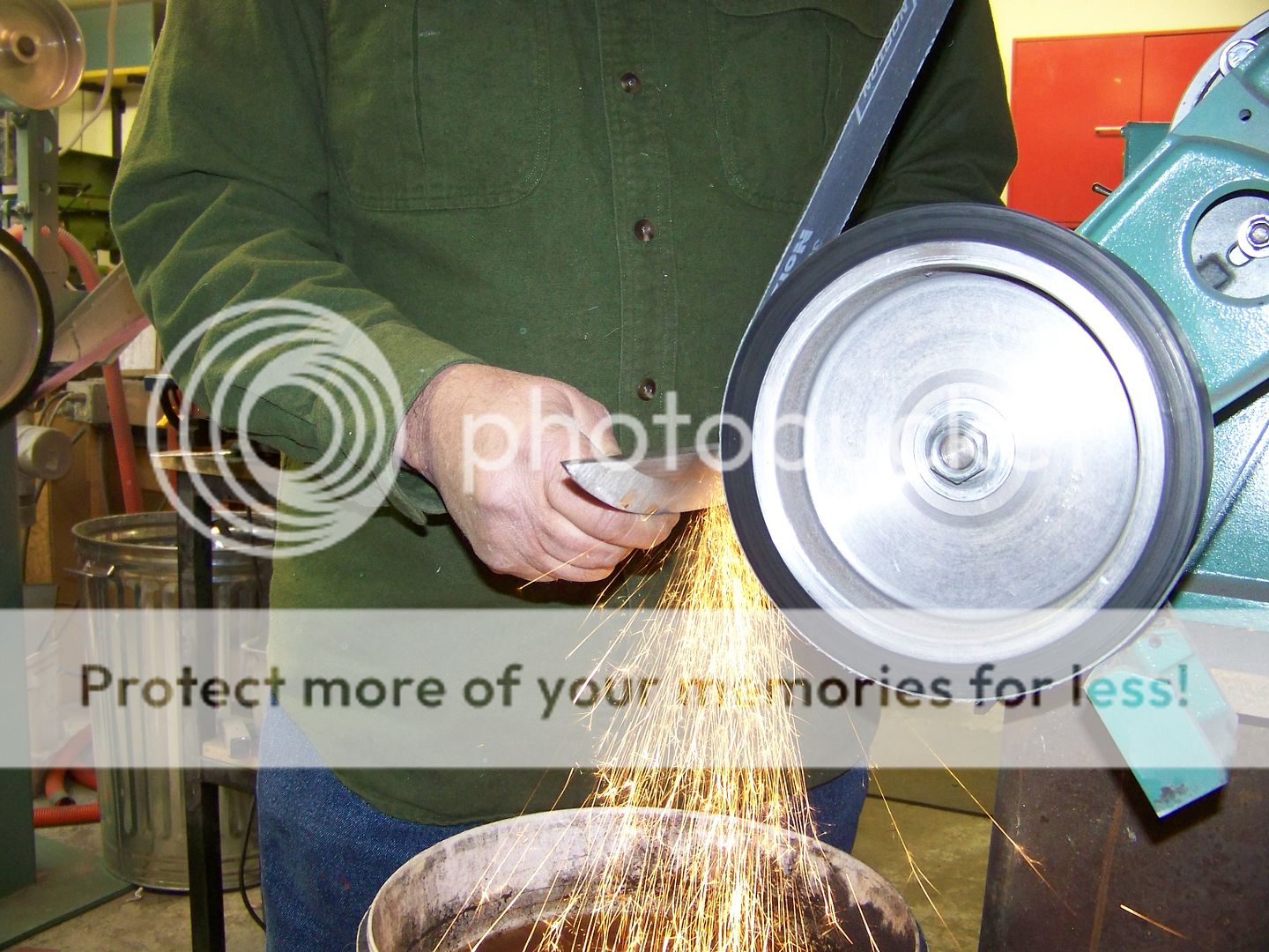

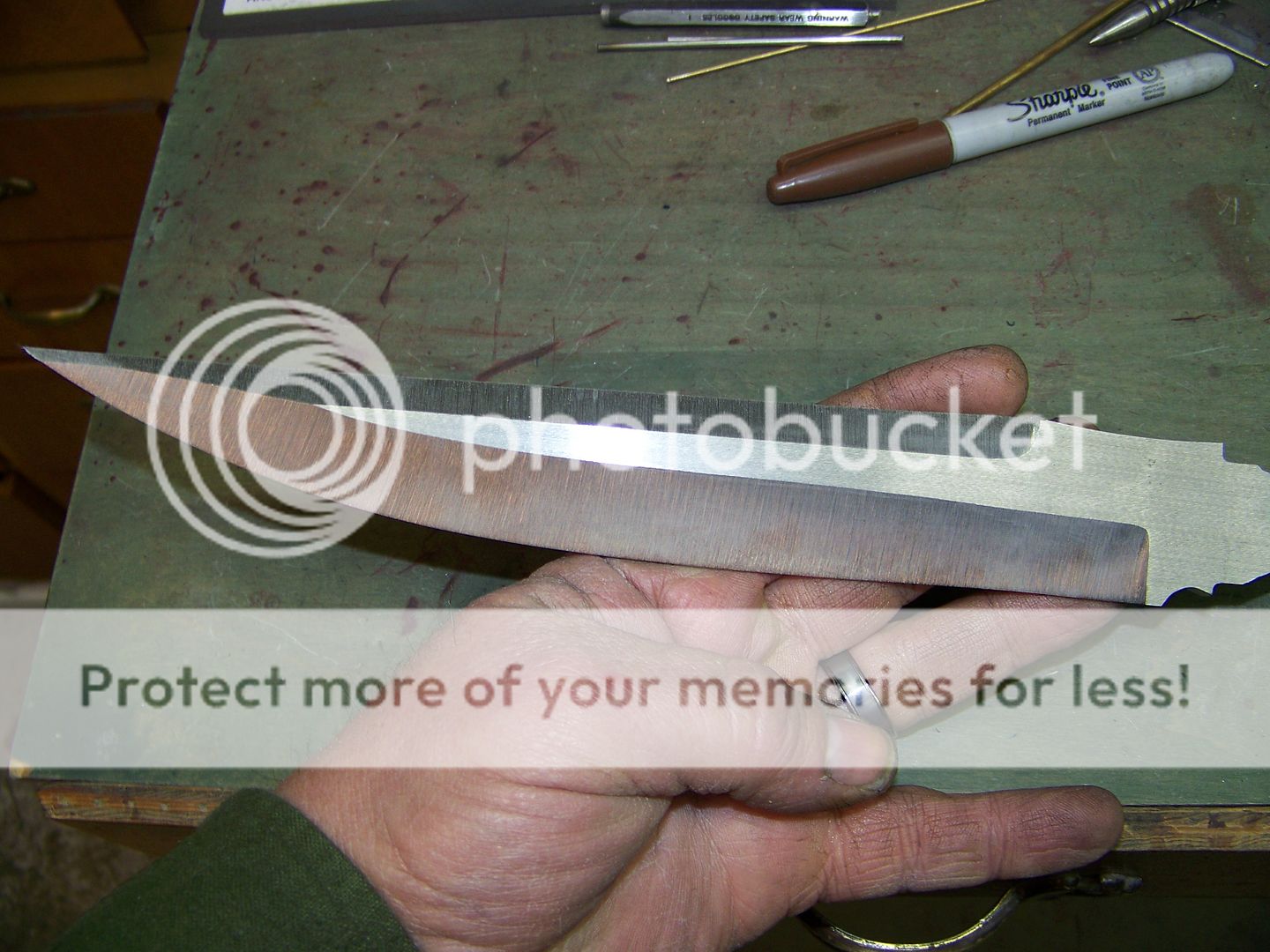

Next comes drawing out the tang. Theres plenty of steel in this bar for this big blade. In order to maintain this pattern on the blade I need to cut it out like stock removal. Its tempting to draw out the blades and bevels on the press but that would stretch the pattern out especially at the tip. I'm liking this even pattern all the way from the guard to the tip. I did however re-forge the bar to the slight "S" shape so the center line of the pattern follows the shape of the blade. Am I making sense? I made a sheet metal template to shape the bar and also to cut it to real size later.

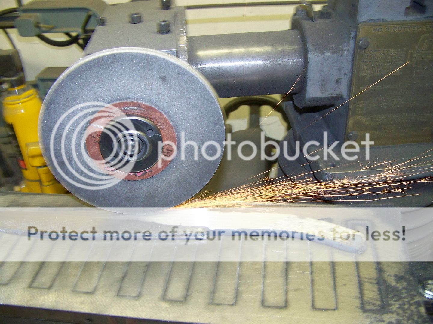

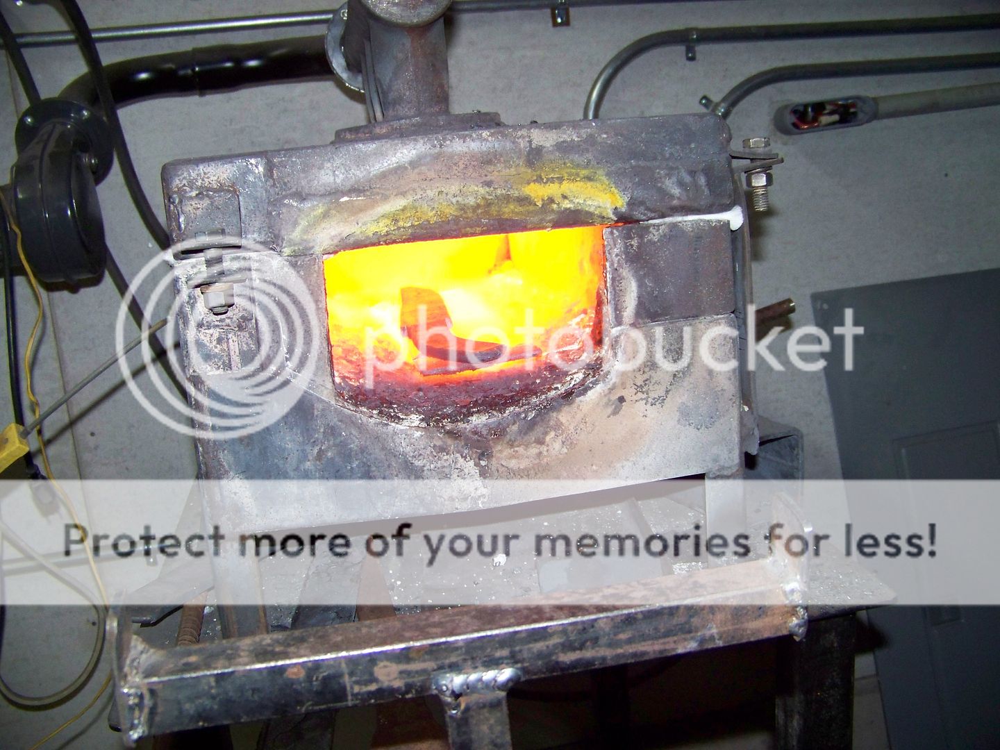

I normalized it in the forge, annealed and stress relieved it in my oven and now more surface grinding to bring it down to flat on both sides. Its still too thick but I still need to heat treat it and surface grind it agian. I plan to leave it thicker than usual because of the deep hollow grinds it will get later. Theres something about a thick spine and fine edge that turns heads. This knife is an all out fighter for sure. Its not the best chopper although it did get through those 2"x4"s. I'm sure stabbing and deep slices are more at home with this one (heaven forbid)

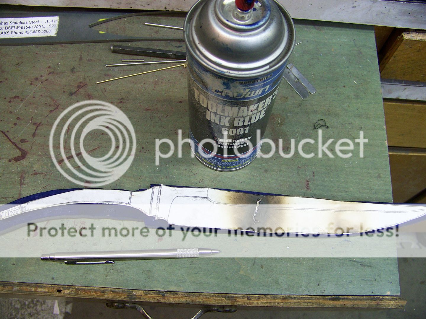

This knife is shaping up, in fact it has the handle frame roughed out and and is in Steven Rapps capable hands for the custom leather sheath with stainless throat and tip. He will send the sheath on to Brian Hochstrat and the bowie back to me to fit the scales to it.
Here are some catch up shots but to see the real WIP you really need to go to: http://www.customknifecollectorsassociation.com/vbulletin/showthread.php?t=1002

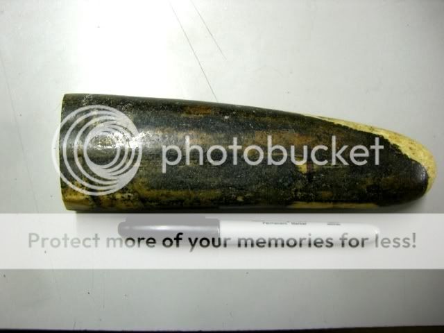

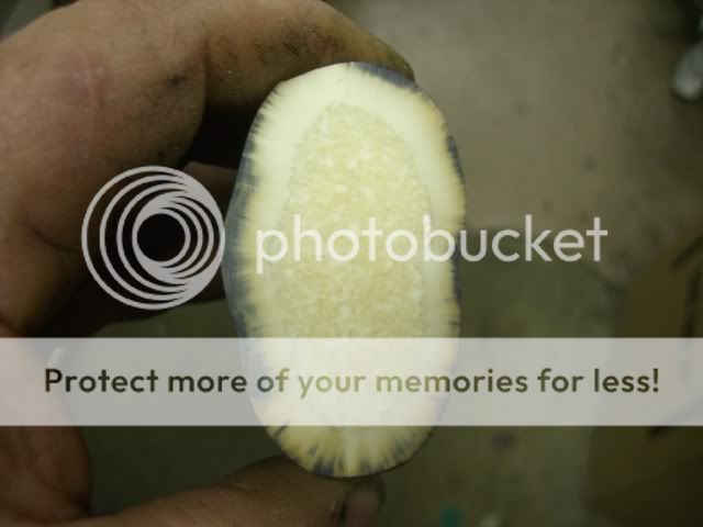

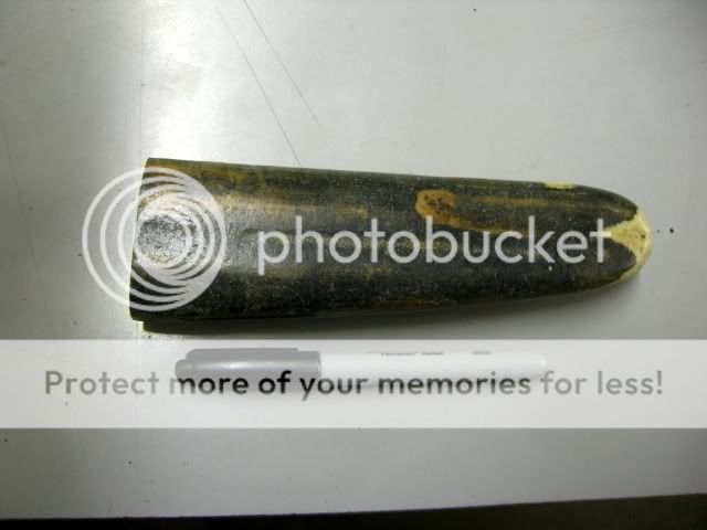

I got some great news from Bruce today. Forum member Mark Knapp donated a beautiful Walrus ivory tip for the handle scales on our benefit knife. Thanks so much Mark as that will add quite a bit more to our contribution for cancer research.
It's a great knife and a great cause and I'm happy to be a small part of it. I can't think of a better place for that ivory to be. It left in the mail today Bruce.
