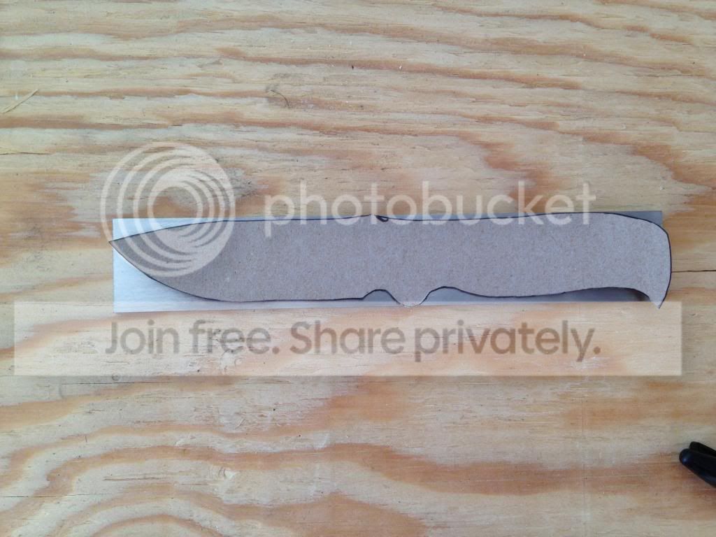

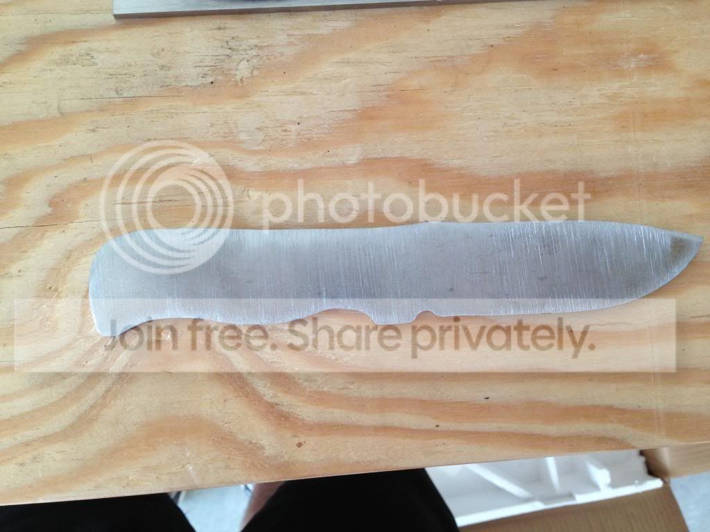

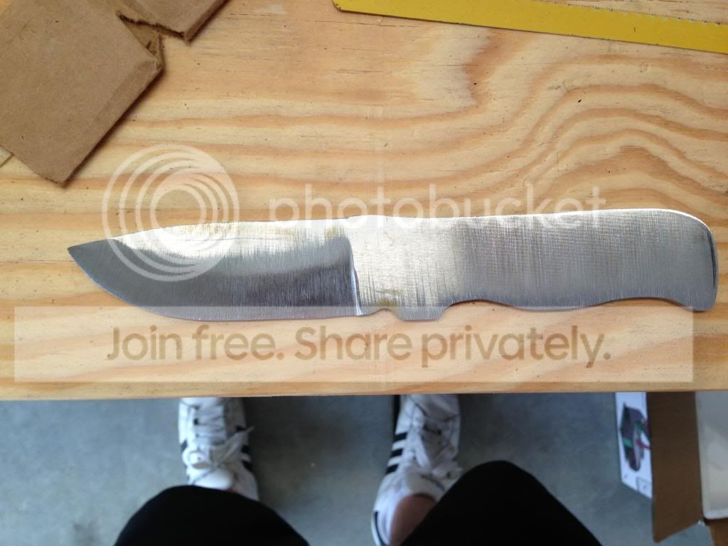

Here's my question. I am currently building my first knife. I am using O1, 3/16" steel. The knife has an OAL of 9", blade length(cutting edge) 4.1", and handle length is 4.75". I have already cut out and shaped the knife, and started grinding the bevel. I haven't marked my hardware as of yet. I will be doing that this week and drill the holes. I plan on doing everything myself, to include heat treat with a one brick forge setup, temper, of course the finishing grinds, and handle material. So I am at the handle right now. I already know that I am going to use micarta that I will make out of an Air Force Airman Battle Uniform (our newer style of camo) and I think it will look pretty good. My question lies with the handle hardware. I am currently torn between torx flathead stainless hardware or possibly basic handle pins for this specific knife. I am looking for your recommendations for handle hardware and some suggestions on what you think would go well with this knife. Thanks everyone for the read.
Here's what I have so far.

Thanks, Pete. I used a good old hack saw to cut my steel in half. I was pretty apprehensive in using my angle grinder for rough shaping, but I finally got it out and was glad that I did. After that I moved to a half-round file and flat bastard file to do some smoothing before moving onto the 1" x 30" belt sander. I will use a hand drill to drill my holes for the handle once I figure out what hardware that I'm going to use. Where are you at so far with your knife?
