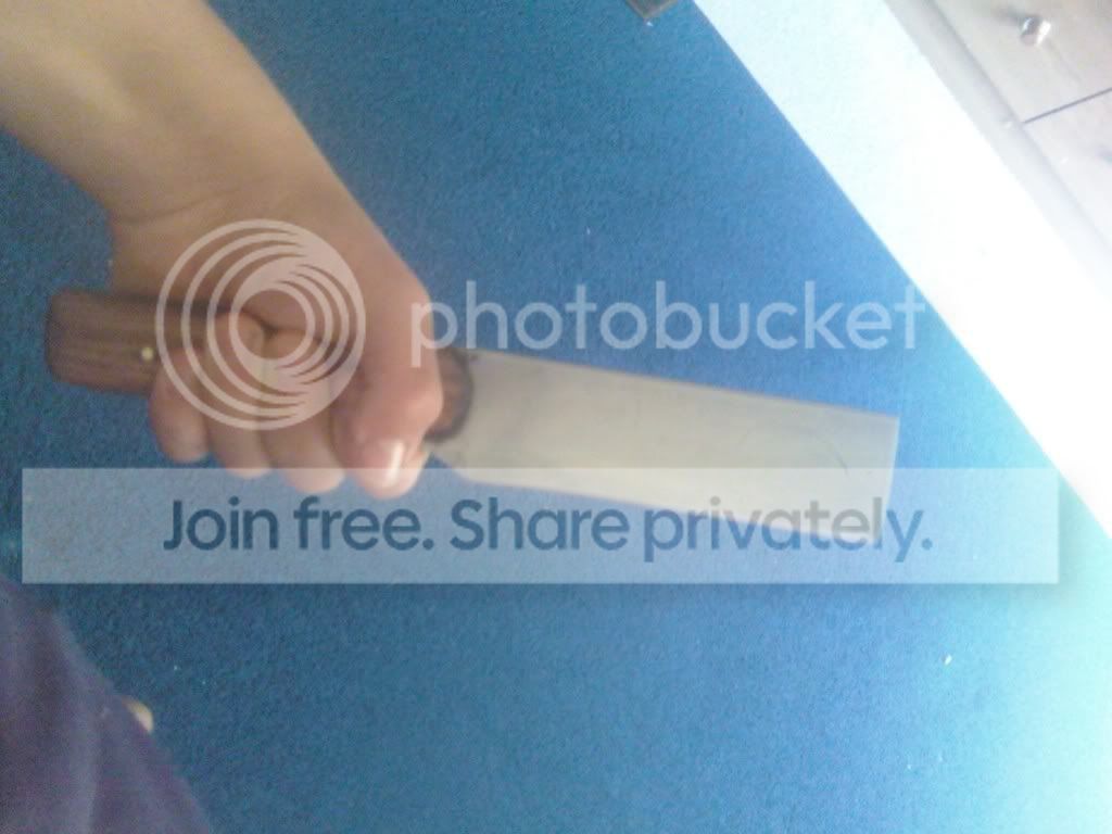

First off. My name is Spencer. Im 13 years old. Soon to be 14. Ive been making things since I was younger. I just recently started making knives at the beginning of this year. Ive made 3 knives. This is my fourth. A small chopper/cleaver. Im making it for my best friends father. Its 5160 steel. Blade length is 5.5 inches and 1 3/4 inch wide, and handle length is 5 and 1/8 inches and 1/4 thick. And the handle will be Red Oak.
Now before HT all I have to do is clean it up. Also Ive heat treated 1080 before. But never 5160. In the kiln I have access to only reaches 1470 degrees fahrenheit. Would it be possible for me to get a good heat treat on this 5160 steel at a temperature of 1470 or below? If so what temperature?

.Welcome to Blade Forums:thumbup::thumbup: 1475 is where it becomes non magnetic so you need to get it a little hotter because you lose some heat going from the kiln to the oil.1500-1550 is what most use.Why does your kiln only go to 1470?

Thanks.It was my Grandfathers glass kiln. He read it wrong. I went to his house and it goes to 1800. I will be doing the heat treat tomorrow. Ill let you all know how it goes.

Thanks. Pics are full size. They were taken on my cell phone. So they arent that big. I will get some better pictures soon.

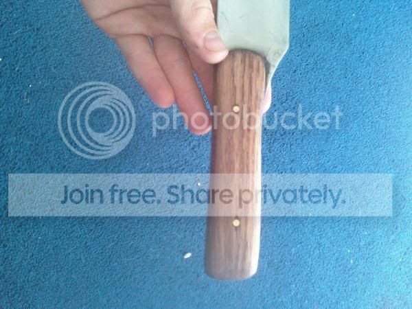

Heat treat went good. the knife is finished. These were taken before I sanded all the excess epoxy off.
heres the red oak handles
