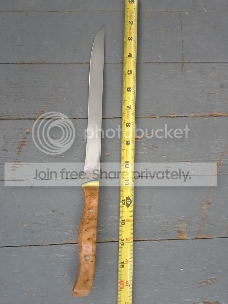

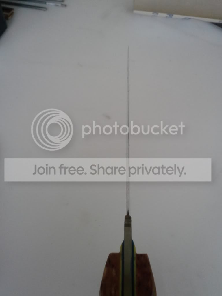

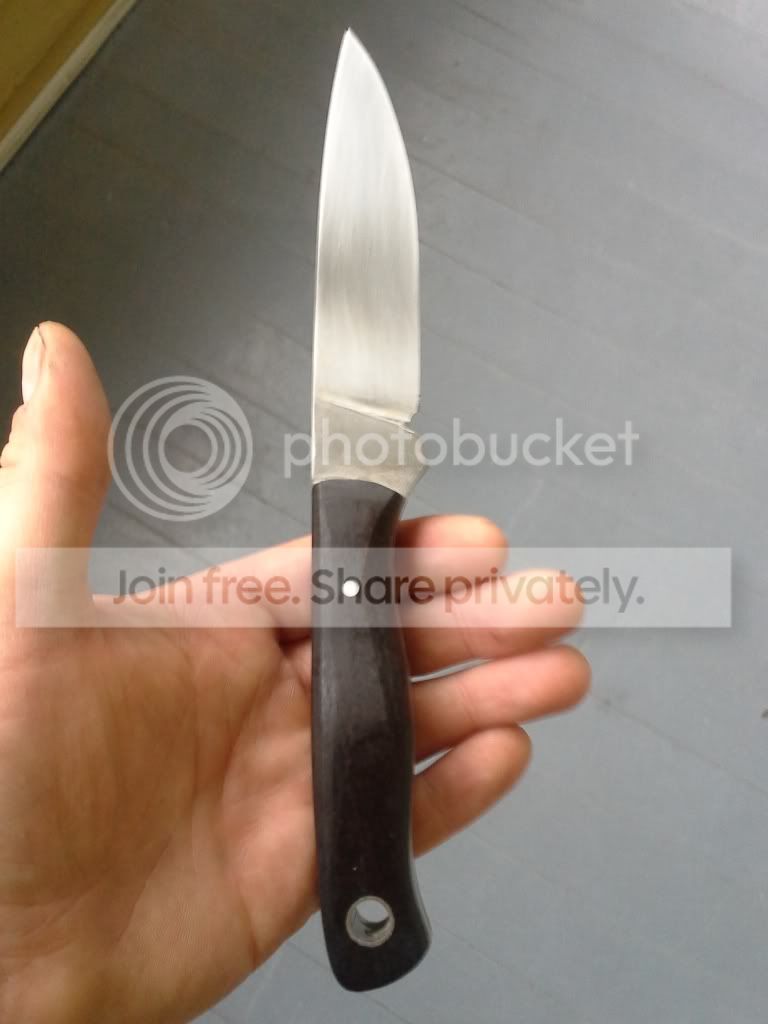

First knife is AEB-L .110 thick
Heat treated by Peters in PA, to RC of 60
blue and yellow g10 liners (swedish colors)
Stabilized Birch handle
304 SS pins with West systems clear hardener + resin

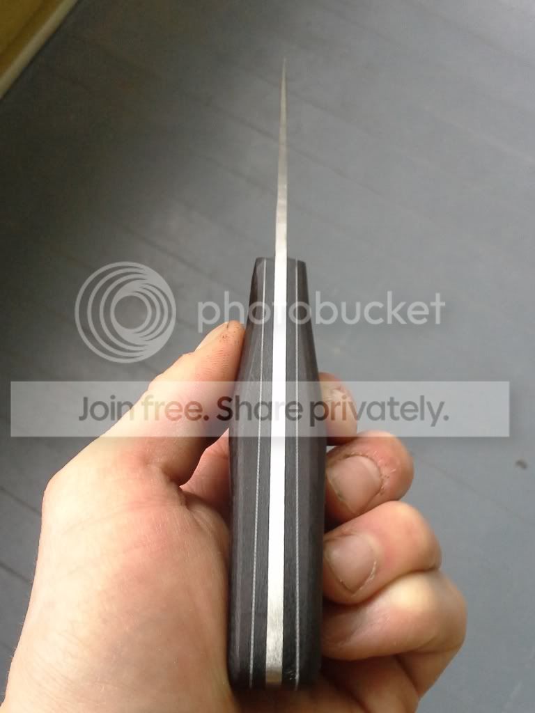

I do have a formula for working out all of my costs. Now this is a knife meant to be used and I am not planning on spending the time sanding out every little mark. It is difficult for me to be satisfied with the fit and finish. Professionally I am a machinist working with + - .005 tolerances on a CNC so ya know... Im not getting even close to that with freehand tools:) But structurally and design wise I feel this will filet many a many bluefish and striper. Is it reasonable to expect a knife like this to be in the 100-150 range?

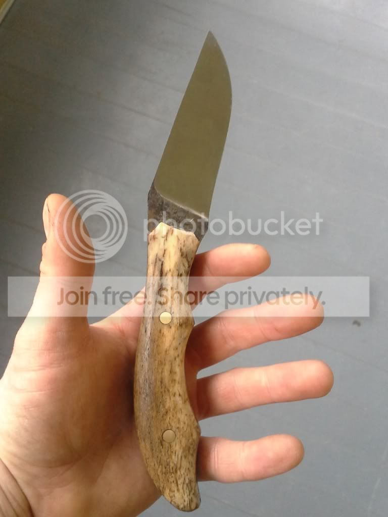

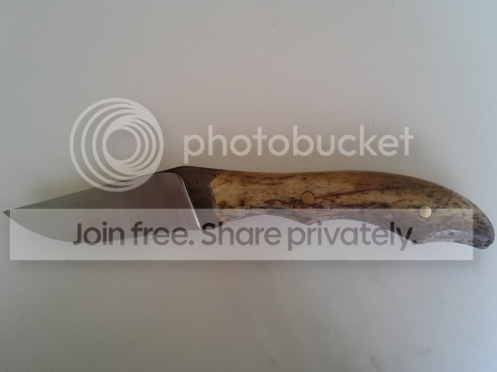

This knife below has been fun, and I actually strayed from the original design quite a bit.
Steel is 1095 at .140 thick
HT by Peters to 58 RC.
I needed to leave the edge rather thick due to the faster oil quench so I still have to do some finish grinding.
The handle was actually a piece of oosik Mark Knapp graciously offered to whoever could guess a fly pattern he had tied.
I split it sanded it and filled in the voids with the West systems epoxy. Had some trouble drilling the material for the Naval Brass pins so I had to fudge the holes up a bit to make it work , thats why there are some glue seams visible. Next time I would probably do a closer fit and peen them before glue up.
Now with 1095 even though it is cheaper than other steels it required more finish work and cleanup time. Actually doubled the time of work over the Stainless.
Id chalk my extra time up to the ole learning curve and also consider this knife to be in the 100 to 150 range.
I suggest that you make your "built in" guard longer on the fish knife and design one into the second knife or of course use a separate piece of metal. On pricing, from what you have said, your work may require more finishing to create an interest to purchase at those prices.On hand made knives this is the often the first requirement. That does not mean however that the blade must have a mirror finish. Often, time involved accounts for very little in the pricing if the finishing looks poor. Frank
This is not something you want to be thinking on handmade knives over $100. Attention to detail is one of the reasons a person would pay for handmade.
I too, think you may want to spend a little more time cleaning up your finishes. The designs don't look too bad though.
Thank you both for the input. I greatly appreciate it! Its kinda the kick I need to slow down a bit and spend the necessary time on the details.

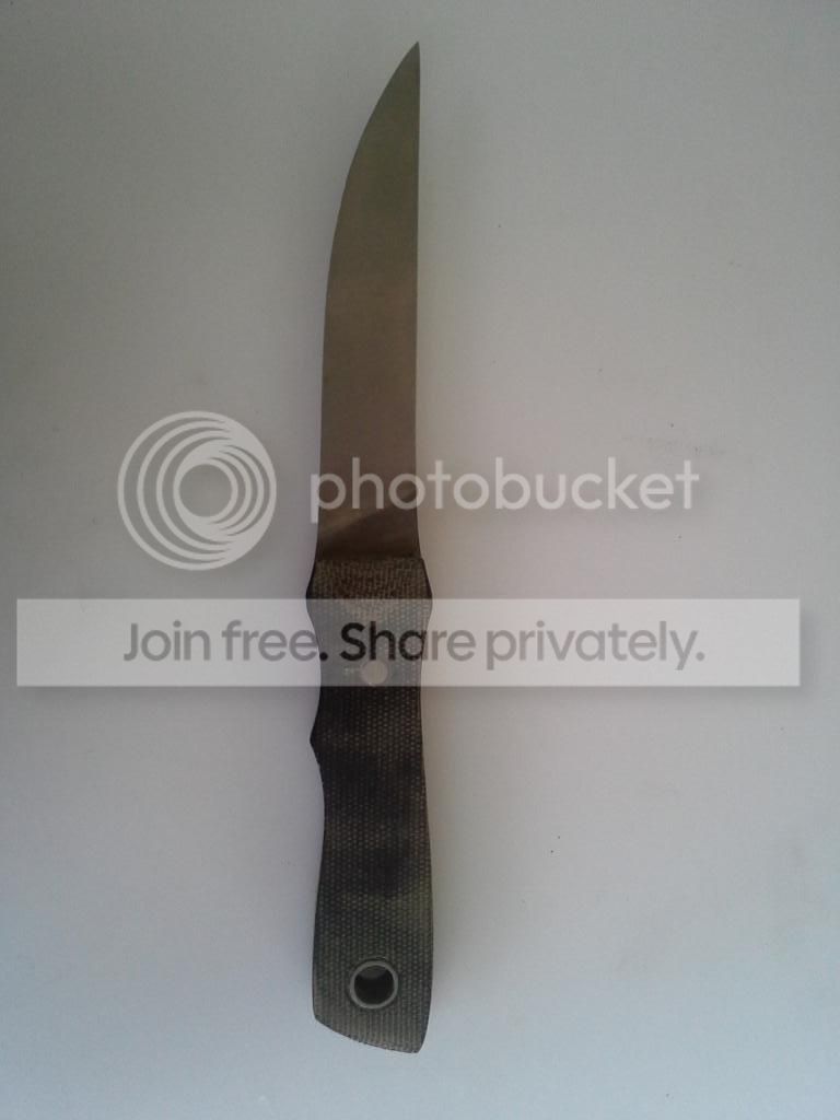

Here is a couple more pics you can see I still have a lot of finish work to do.
The lighting is bad and you cant see the grind lines to good but this has to be one of my favorite overall profiles. I feel like its an interesting blend of many different aesthetic styles. Functionally it is meant as a stout filet/bait knife. Will be testing it out in Cape Cod all summer.
I'm sure Salem will agree you have some good work and styling in those knives. They also look original. I feel having a guard on them will help your sales but am not convinced that the three grades will help. Confusion over is this one of his or is that I believe will I tend to cause a problem. My suggestion is to do your best work all the time. It will help you sell and to increase your prices as you go along. To see some of my work please go to customknifegallery. Frank
I do agree that there is good work and styling here. Even the idea of three grades might work- you'll just have to try and see how that goes if that's what you want to do. Frank is right, do your best work all the time. If anything, let the difference in the three grades be in materials and design. A small utility with a micarta handle and no guard is on the economy side, but should be as well finished as your burl or ivory handle, damascus or S35VN blade with a guard and buttcap, which would be on the luxury end of the price range.
