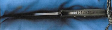

So here is the knife I'm donating to our troops.
Its made of 1/4" O1, with black linen micarta scales, brass pins and thong hole.Blade is 6" long. Overall length is 11".
Here it was before being browned:
attachment.php
Here is now:
attachment.php
attachment.php
attachment.php
I used some browing solution I had left over from a muzzle loader and a few pairs of spurs. Took about 2 days and 5 coats before fitting the handle. This was difficult, I had to boil the blade to get the darker color which meant doing the handle section without the scales attached. I had to have the scales 99% finished so that I didn't have to do any grinding after attaching them. Once I had them epoxied and pinned on, I masked off the blade and tang edges and ground the pins smooth and completed finishing the scales. Then I had a little touch up work to do on the blade finish. I re-cleaned it with acetone and did a few more rounds with the browning solution. I'm pretty happy with how it came out. Browning hardened steel is a whole new ball game over gun barrels and spurs.

The browning solution I used is called "Dangler's Browning Solution" and seems to be a home brew. I got it from The Log Cabin shop when I bought a kit for a muzzle loader. It works very well, and I'm planning on getting more as this bottle is all but gone. They have a web site and do mail order stuff ( www.logcabinshop.com ) I really hope this mix is still available.
I have the name and address of the guy who makes it as well, its on the bottle. I'd prefer not to post that here in respect for his privacy, but if you want some of this stuff and can't find any email me and I'll give you his address.
Its pretty simple to use, but time consuming. First you have to clean any oxidation off the metal (light sanding is fine, nothing extreme) then de-grease it with acetone or something. Paint on a light coat of the solution and let it sit in a warm humid place. It will turn the metal green in short order. Wait 12 hours (12 is for a gun barrel, on a knife blade I did more like 3-4 hours because it rusts much faster but not as deeply) and paint another coat on being careful not to rub off the green buildup from the first coat. 12 hours later, take a brass brush and go over the peice removing all the loose rust. Repeat as necessary, you should start to get a nice skin over the steel. When you've got it where you want, dip the peice in boiling water. This will darken it alot, and neutralize the acid. From there, I apply a coat of oil and use the brass brush on it one more time. After that its good to go. Its a pretty tough finish, and takes oil very well to help prevent further rusting.

This sheath is kydex, .090" and reinforced where the belt loop attaches. I don't know what else I could do to lock the knife in. By itself, you can hold it upside down and shake it. With the drawstring pulled down tight, you can't pull the knife out, not without breaking something. When its pulled tight the paracord crosses overtop both gaurds and squeezes the mouth of the sheath closed (which is molded to grip the knife). This is the most secure set up I could think of, since I don't have the tools to put snaps or webstraps or anything on it. Its not the cleanest work, and doesn't give many carry options but I'm not worried about the knife coming out of it. What else would you do to it?
