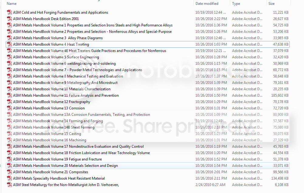

Marc,
Where did you find all those PDFs?
If you know how to use google to it's full potential, if it's on the internet, it can probably be found. I've developed a few techniques for scouring the internet for such things. I spent about 3 days digging till I found the jackpot.
