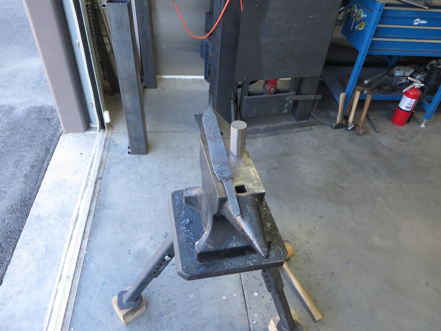

Took me a little less than an hour and a half today forge a d-guard bowie from 1-3/4" drill rod of O1. My little air compressor did not have any trouble running the hammer. Every time it would turn was about time to reheat the steel. I have not ran a power hammer of any sorts since going to basic bladesmithing school and Damascus school in Old Washington AR. in 03-04. So I'm sure someone who really knows their way around a power hammer could have done it faster. The hammer didn't wake up my neighbors and was pretty easy on the floor.

I'll look for the app. I definitely had ear plugs in. Mostly because the air compressor is pretty loud when it kicks in. Of course I wear ear plugs when I'm just forging on the anvil with a 2 lb. hammer.
What size compressor do you have? I have been trying to decided between this hammer and a Anyang 88.

I ran a simple husky pro 60 gallon upright air compressor. As soon as the drill rod needed reheating the compressor would come on. By the time it was up to heat it had shut off. It only has a 3.2 hp. engine running on 110. I would like a bigger compressor but I haven't found a good one at a decent price yet.
