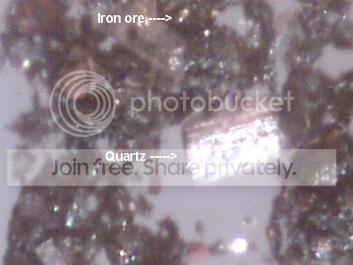

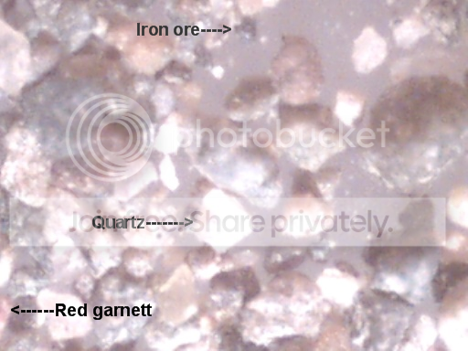

Before you try to smelt it you may want to check to see just how much iron is in it. The magnetic sands around my area are very low and do not smelt out very much iron. The iron is always attached to different minerals.
If you send me a small sample I can look at it under a microscope and take some pics. That will give you a better idea how much actual iron you have.
This is some hematite I bought from a pottery store. It has very little silicas/quartz.
This is some of the magnetic black sands from off my place. Even though I used a magnet alot of crap is bonded to the black iron specs.
