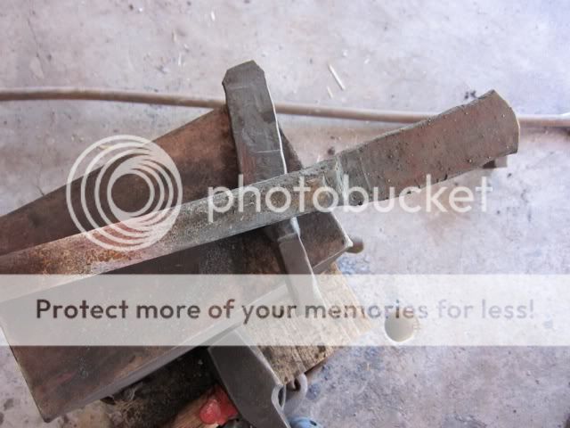

To make a long story short... I ended up getting my hands on some phosphoric wrought iron salvaged from an old grain elevator so I made some blades from it by forging to shape from 1.5" bar and then cold working the edges down. Here is the fruit of my effort... a 'short sword' with 18" blade inspired by certain early Celtic styles with riveted handles and lenticular (lens shaped) blades. This was NOT an attempt at a strictly accurate historical replica. Just inspired. But it has the look I think. The handle material is basically morticed and riveted through both the tang and the blade. It is East Indian rosewood and some unbelievable black oak from ItsaBurl.

Here I am doing some blows on the spine in an attempt to stiffen the entire blade and keep it from bending so easily. Before doing this you could practically wrap it around a tree by whacking it broadside. And I did. But after hammer hardening, you could only almost wrap it around a tree. Not looking good.
But then I started working the edge down..first with a crosspien, then with a heavy sledge to smooth out the marks. It is amazing how tough the iron is on the edge when really giving it with the hammer. You keep thinking it will split, crack or crumble, but it doesn't. I actually cold hammered a hollow grind it in it:
After doing this, I took it to the grinder to clean up and then went back to the anvil to do some lighter hammering right on the edge. I hammer it until it's thin enough to sharpen.
Well after doing this, it really started getting some spring in it. I could put it in a vise and actually flex it (a bit) without it taking a set. And whack trees broadside? Well.. I was no longer wrapping it around a tree, but it still bent pretty good.
