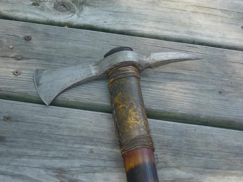

On the old forged tomahawk and trade axes i've seen, pre 1830s or so, if the material is listed or i can see up close (wrought rusts differently and you can sometimes see the grain, almost like woodgrain), they're always wrought iron, never steel. Apparently large straps of steel weren't commonly available or needed for axes. Most do have a small piece of steel forged welded at the blade edge though because wrought iron has no or little carbon to heat treat for a hard cutting edge.
Wrought iron (not cast iron which would'nt work well for an axe) is GREAT to hand forge, it's much softer and easier to pound, fire weld, and more rust resistant than steel. The thing i don't like about it though is it must be pounded a couple hundred degrees hotter than most steel or it splits along it's grain.
Usable wrought can still be found in wood wagon wheel tires and lots of wood fence post anchors around here are old wagon axles.
I found a broken blade from a small trade axe or tomahawk at an old Mohawk-Wyandot village near my house that's wrought iron with no steel bit.

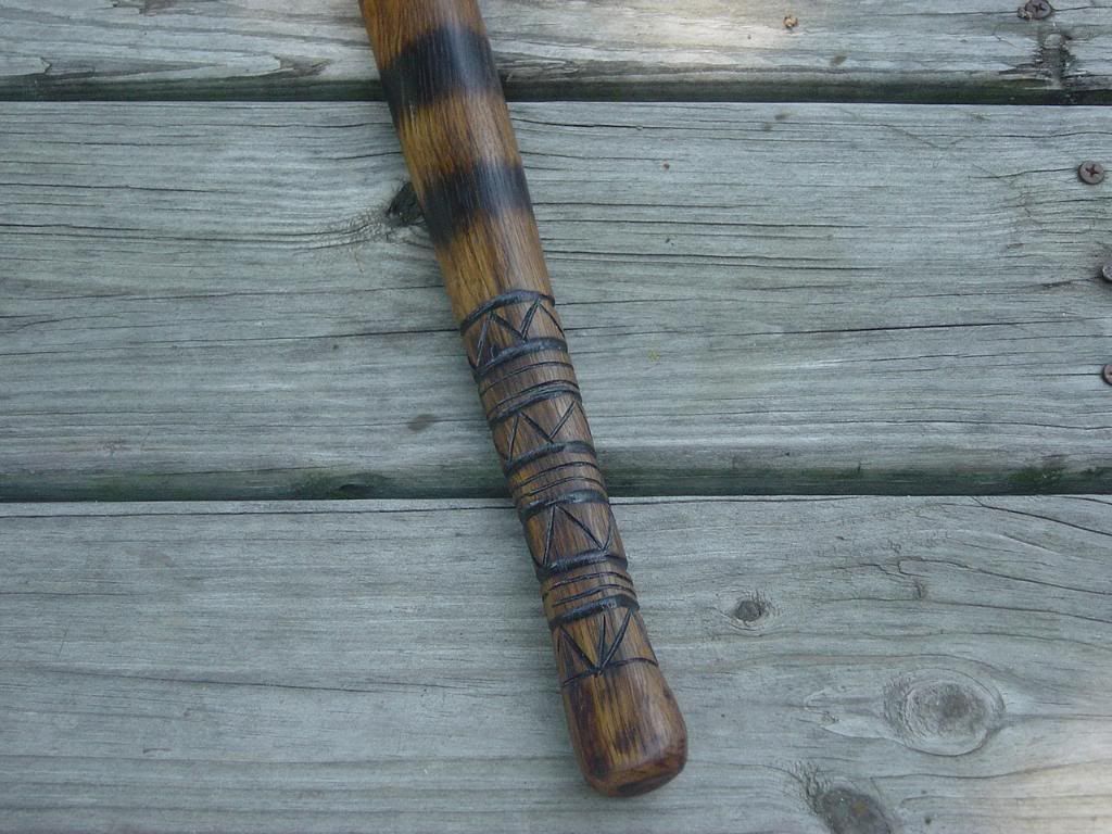

Here's one I forged from 1" square wrought with a file steel bit that was recently sold to a forum member.Haft is weathered barn oak that is 100 plus years old.
that etched wrought is beautiful stuff!!! I haven't tryed a slit and drifted type from wrought yet , I kinda figured it might be tough to drift without tearing it apart, but as soon as i get caught up on other work i'm gonna do some.
Thanks for the comments guys. I have a good bit of 1" square wrought bars that I purchased just for forging hawk heads.The wrought drifts quite well, as long as you keep it HOT! One thing to remember is do your upseting before the eye is drifted. If not you will distort the eye so bad that you may not be able to straighten it out.I also like to start me slot by drilling and millin as opposed to hot cutting, as I can never seem to keep them straight by hot cutting. If you do encounter some separation, in most cases you can forge weld it back shut.
