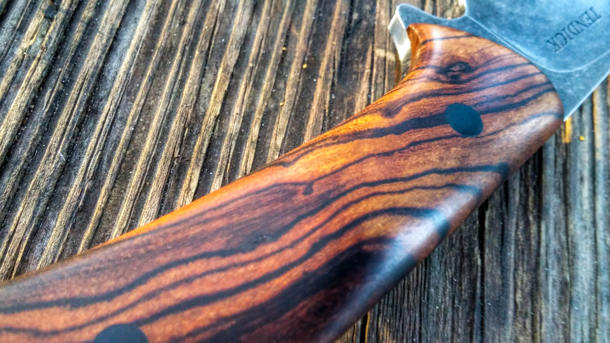

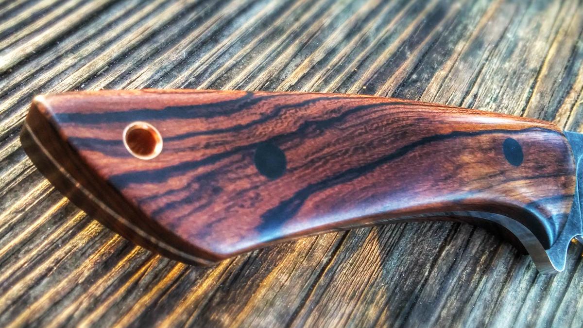

What I ended up doing was mixing mineral oil with baking soda and giving it a rub down.
The natural oils of the ironwood seemed to be a bit mottled.
This actually worked very well, as it made the finish more matte and the color really comes out now, but I did not sand away natural changes in the wood, and it did not make any wood dust.
I got the tip from a forum member who used baking soda and oil to repair a finish on wood that had been damaged by isopropyl alcohol.
All of the advice here is great.
I did not document it, my apologies.
I think it acted more on the surface oils than the wood. The effect is very pleasing and it did not scratch at all.

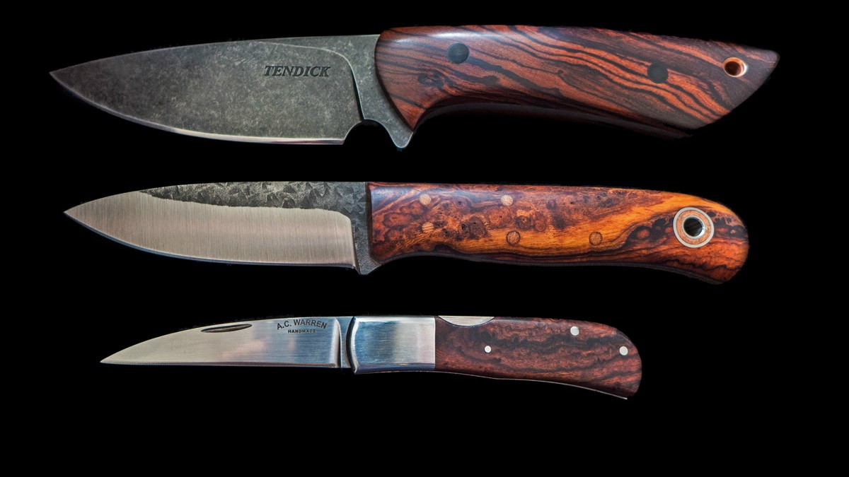

I ended up starting off with the top knife in this photo, the BRT compact scout, shown here next to a Fiddleback Hiking Buddy and an Al Warren lockback (all in ironwood)
It isn't the best photo for comparison, since the lighting is different, but as mentioned in the original post the surface oils had developed a hazy appearance similar to a fine slurry. Cleaning it with the mineral oil and baking soda, then washing the blade and scales, then wiping it down with a cloth with very light oil cleared up the hazy effect and brought out some of the natural chatoyance of the wood (golden flecks and shimmering characteristic of premium ironwood). It didn't brighten the wood, the color change is a result of sunlight photography only.
It was left with a very pleasant matte appearance of the natural wood and there is no more haziness in the light.
I have not done it on one of my Fiddlebacks yet but based on these results I would not hesitate to use baking soda mixed with mineral oil to clean up a hazy or mottled oil finish on the top surface of ironwood. I would compare it to a very fine grit polish. It did not remove wood but did even out the presentation of the surface oils. Washing with dish soap and buffing lightly with renwax might have had the same effect but I can't say for sure. Auto-detailers often use it to polish chrome and I have seen it repair water-stain and alcohol-stain marks on wood with a damaged polyurethane coating.

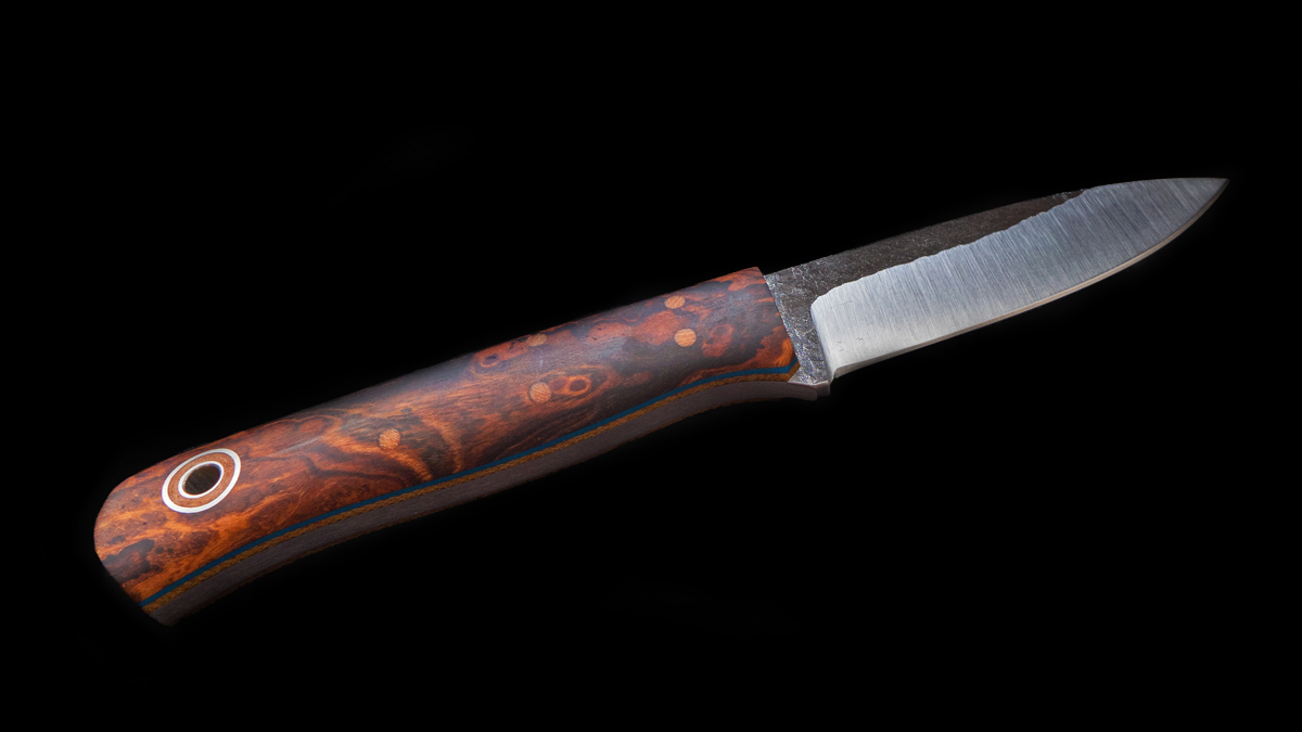

For good measure here is another pic of that sweet HB which has not needed the treatment.
