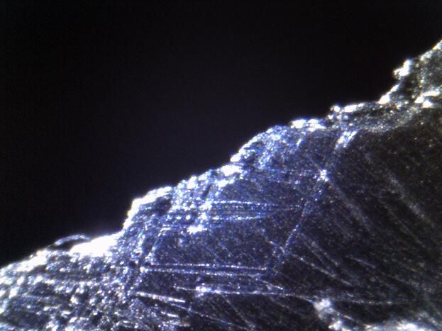

CliffStamp "Sharpening" Playlist #1 Basic three step knife sharpening : destress the edge + shaping + finishing the apex
For extreme burr example raised with 36 grit
here is what the apex looks like

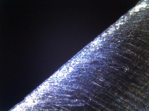

And here it by more carefully trying to avoid raising a large burr by monitoring sharpening progress by reflection and using light force
And here is after the stone is heavily worn and its cutting very very slow.
The very cutting edge, the apex on a knife is about 1 micron wide,
its like a 1 micron wire ,
its very easy to bend as its so tiny
1 micron is 1/1000th of a millimeter,
printer paper is 100 micron thick,
average beard hair is a little thicker around 120
And just like a paper clip, or a coat hanger,
bending damages the wire and the damage goes deeper than the point of the bend ,
and it can produce spectacular results ;)
as can be seen in this video Issues sharpening a heavily abused knife - Yanagi-ba - Cliff Stamp whose thread has pics

The entire topic of burr formation, burrless sharpening, burnishing mechanisms is tough to pin down.
In my experience, using a smooth steel on low RC cutlery improves edge retention. Nothing crazy, but there is an improvement. I liken this to the small anvils used to workharden the edge of certain unhardened/partially hardened agricultural cutting tools (Fortytwo blades can elaborate on this better than me). Yes, repeated steeling will lead to brittle failure or a drawn out edge at some point, but all edges dull anyway and whatever maintenance is needed after the initial cycle, it doesn't matter if you continue steeling or take it to a mug or stone - the edge became dull from use.
Part of an experiment I ran on higher RC sporting cutlery (58-60), coming off of the initial bevel setting I smooth steeled the edge with upwards of 3-4 lbs of pressure at the exact same working angle, using a 1/4" hardened rod. In some cases this drew out the edge a small amount, in many cases it didn't. The edge was then finished with either a microbevel or at the original angle with a finer stone. If the edge had experienced a pressure burr from the steeling, this was removed with the higher angle and edge re-established at the target angle.
These were compared against edges that did not have this pre-treatment. The hypothesis was twofold - either the edge will fail early due to subsurface plastic deformation, or it will last longer due to the effect of workhardening increasing tensile strength and hardness.
There was no appreciable difference between the four preparations.
I have likewise run tests using plateau sharpening vs edges crafted with a small burr. Again, there was no appreciable difference.
Theoretically, any workhardening from flipping the burr should actually be beneficial - increase tensile and hardness trade off for decrease in ductility. This is the exact strategy employed in many laminated steels, tho arrived at using different process - the cutting edge doesn't need to be ductile. Take a piece of 3/4" copper tubing and bend it 30-40°. Now bend it back. Repeat. You'll find it gets extremely tough, tougher than you might have imagined if you've never actually done this before. Which would you rather make a cutting tool from, the workhardened piece or the original highly ductile piece? I realize this is not the same as a knife edge, but then neither is the paperclip analogy.
Ultimately, I came to the conclusion that whatever effect this factor contributes, it is absolutely dwarfed by other contributors. Tracking this down would require a huge sample from many different participants. When one person is prepping and testing for all we know the only thing we've learned is that they're better at one form of edge finishing than another.
