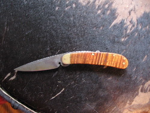

No. A friction folder has no spring, is opened with a "lever" on the tang end of the blade, held in place by a tight fit and you are holding the lever when it's open so it won't close while being used. Here are a couple of bad pics of one I made a few years ago..Someone will post better pics I'm sure.

great knife pipeman
The curly maple was a load of firewood that I got a few years ago ;-(
2 cords of presentation grade curly cut into 16 inch pieces. Oh well, i have enough to make knife handles for life.
