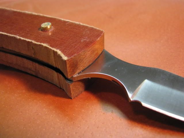

Here is a Micarta-scaled knife that has been sanded to 80 grit.... just getting started on it. But...if you look at the end of the scales, up front where scales meets blade, you can see where I've sanded and polished the Micarta before glue-up. I do that because it's the area of the scale that really can't be reached after glue-up, so it must be done before. The actual knife is completed now, but I don;t have pictures yet. The point is, only sanding and buffing is required to produce a smooth, shiny surface.

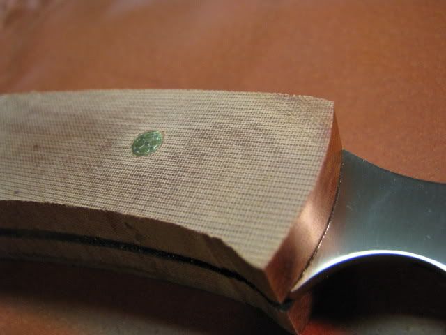

Here is a picture as the Micarta arrives from the dealer. It's surface has been sanded and buffed. I don;t believe there is any type of finish on it other than maybe leftover buffing compound embedded in the pores...maybe.
