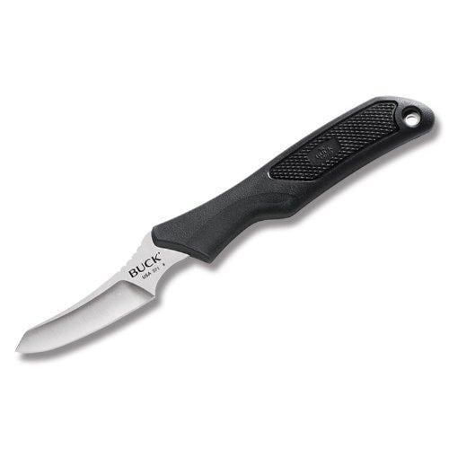

Take a look at some Caping knives. They’re purpose built for skinning in tighter areas like the head and ‘cape’ and have larger choils and recessed areas on the spine for your index finger. Essentially a knife designed for choking up on and having fine tip control.
