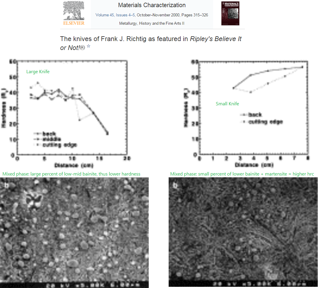

I didn't purchase the published journal - therefore poor image quality (sorry, can't shout to my minion to 'enhance it' :D). Obviously, ht params are differences between large & small knives. Keep in mind (a neutral fact) - edge can't cut something harder than itself w/o deformation. A 45rc knife (Richtig's large knife) edge can't cut a hardened lock 55+rc w/o edge damage.
Actually no material can cut anything without damage even if you got a diamond and cut things magnitudes softer, the diamond will give eventually. How big or small that damage is is the key.
