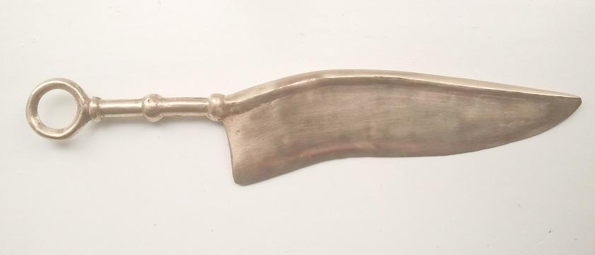

I am really looking for a pure iron ore knife it this point, I wanna really go old school...
Boooooo, be a man. Go Bronze-age! :thumbup:
Disclosure: pulled this image from the internet, it appears to be the work of a member of another forum. I am not posting this here in an attempt to get anyone to go there, or to buy it. This is for comedy purposes only.
