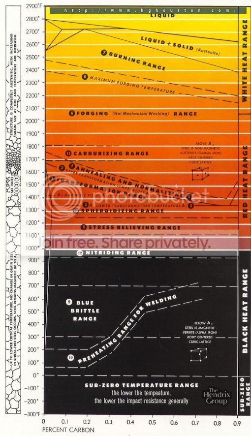

Old school color chart will help you out, along with a magnet. Hopefully you can familiarize yourself with the general parameters of color/temp before your next go. It's about as primitive as it gets and by no means exact, but in general the chart works well when lacking certain luxuries.
