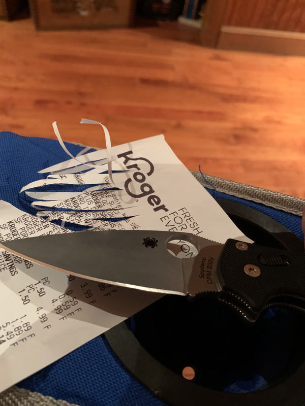

Let's see how sharp your knife is. I'll go first

Right now, without question, my favorite knife is my Wusthof Gourmet Chef's Knife. Yes it is more of a budget knife but I love it. I embarked on hand-thinning this one (not something I necessarily recommend for this size) and it still needs some work but the performance enhancement is excellent.
This was sharpened on a Norton Fine India, honed on a Black Arkansas and then lightly stropped on bare leather. It's been a few weeks (and daily use) so it's catching a bit but still cross cutting paper towels and feathering across grain on receipt paper.
This guy is pretty easy to sharpen but cleanly cross-cutting receipt paper is more or less my gauge for all my knives.
To be frank, although my previous test was zipping cleanly through receipt paper, I'm currently playing with a well stropped 600 grit edge which is a nice toothy edge to have on a working knife and will still shave arm hair. It does make more noise going through those receipts though.
