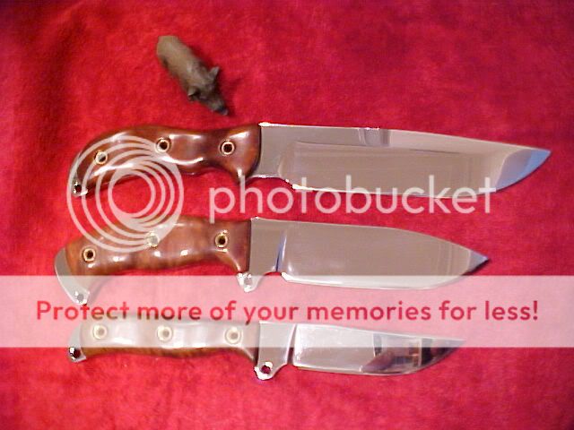

Absolutely!
Busse killa zilla
Busse NMFBM
Better mirror picture of the NMFBM.
All reprofiled by me and full convex ground.
That's very nice, but it's far from being a mirror finish. I can still see all the grind marks on it.
BTW, knives are maintained on a strop with green compound, followed by pink compound, then bare leather. Can easily get good results with just the green compound however.
I should add however, that using just sand paper (2000 grit is as high as i've seen) will not get a high mirror finish. I power sharpen with belts, then power strop with a leather belt, then I go to hand stropping.

Knifenut1013 convexed my Izula....quite the mirror finish on this edge....he was shaving hair with it when he was finished.
Sure it works, I did these and others with sandpaper and strop:
I find that a polished edge is pretty easy to maintain, just strop it ounce in a while, or you can always touch it up with the sandpaper if it gets too bad.
