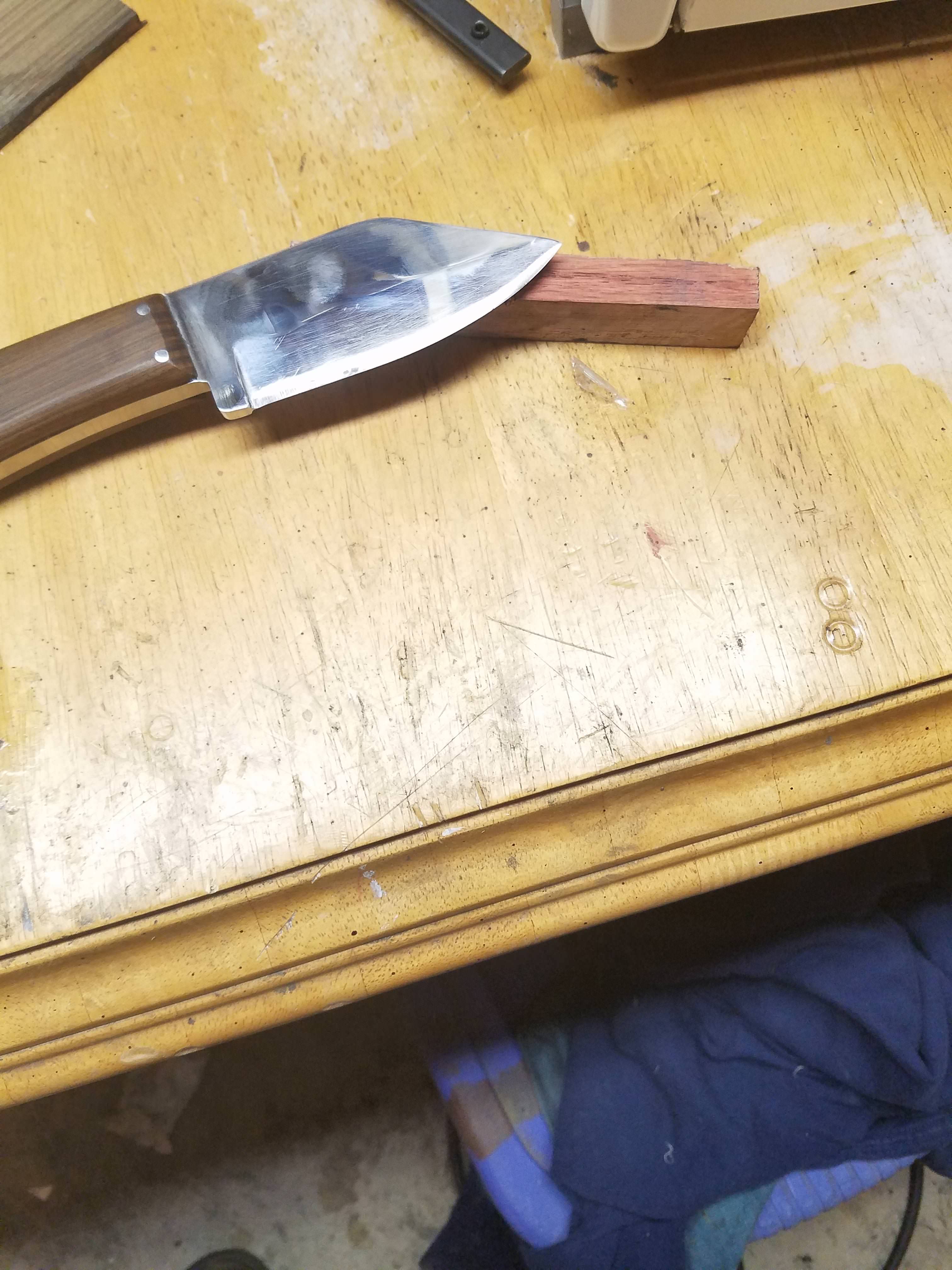

I have a knife I just made with a 3.5 inch blade. It is made of 5160 and the handle is lignum vitae. This is only the 3rd blade I have made. Is 64rc to hard for the blade? The handle is 35rc. I am new to the forum and blade making, so be gentile..
Here is a picture

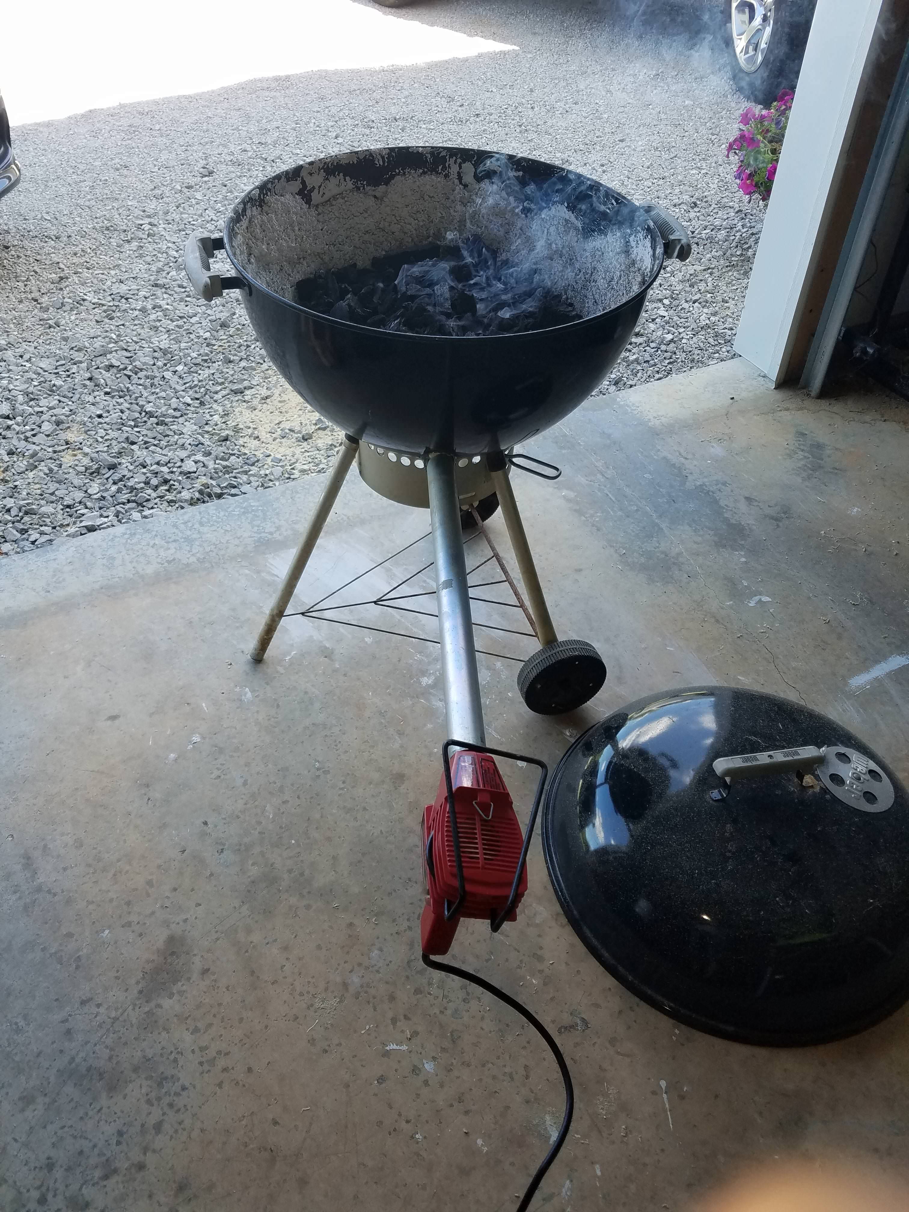

I am using a homemade coal forge from an old grill.

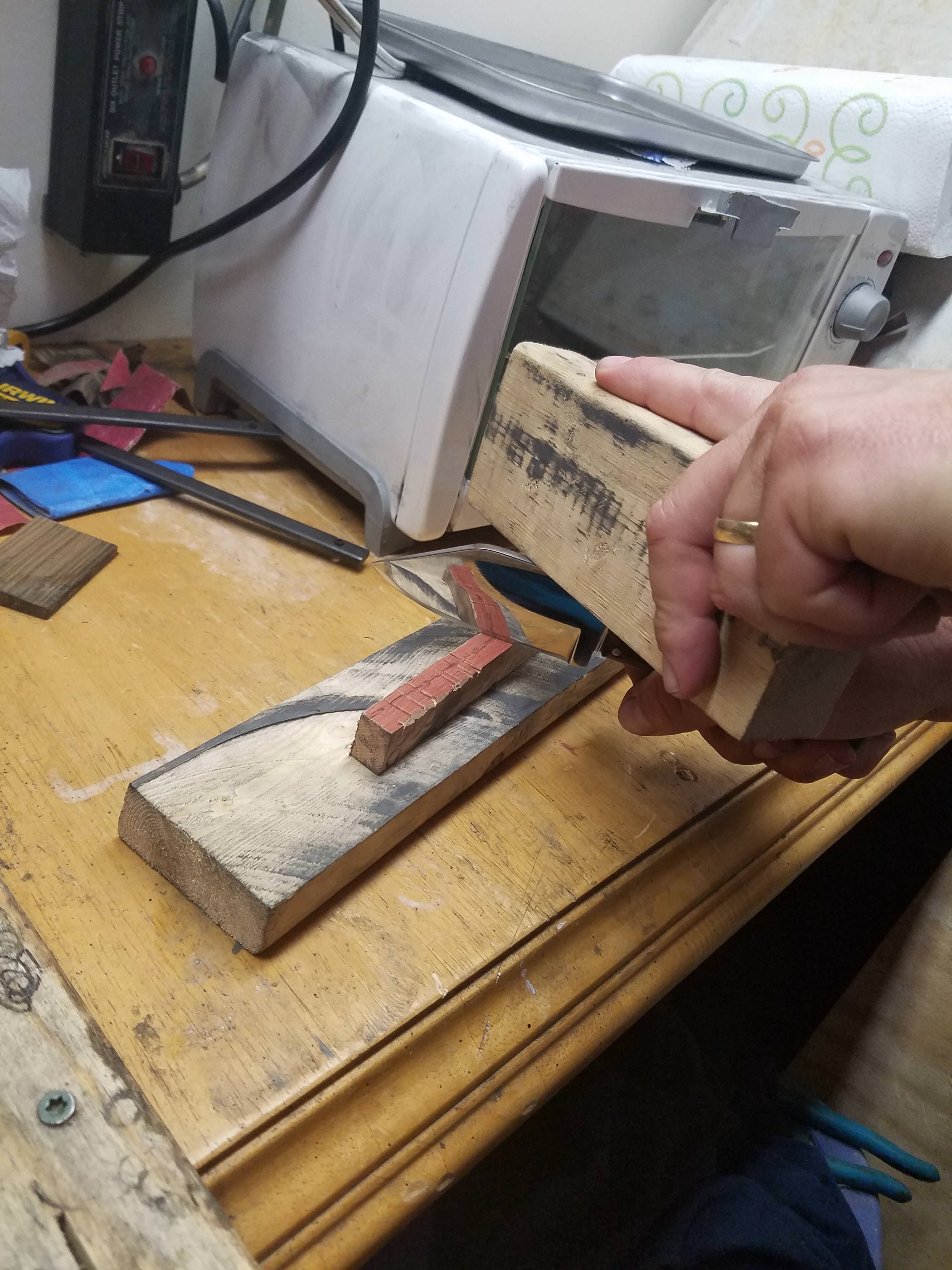

I heated to non magnetic and air cooled 3 times. Then heated to non magnetic and quenched in vegetable oil preheated to 120 degrees F. After cooling, I brought a toaster oven up to 350 F (verified temp with a meter and RTD) for 40 minutes.
You really need an extra 1 'n 20 minutes at least. I'd go for a 2 hr temper in addition to what you've already done.

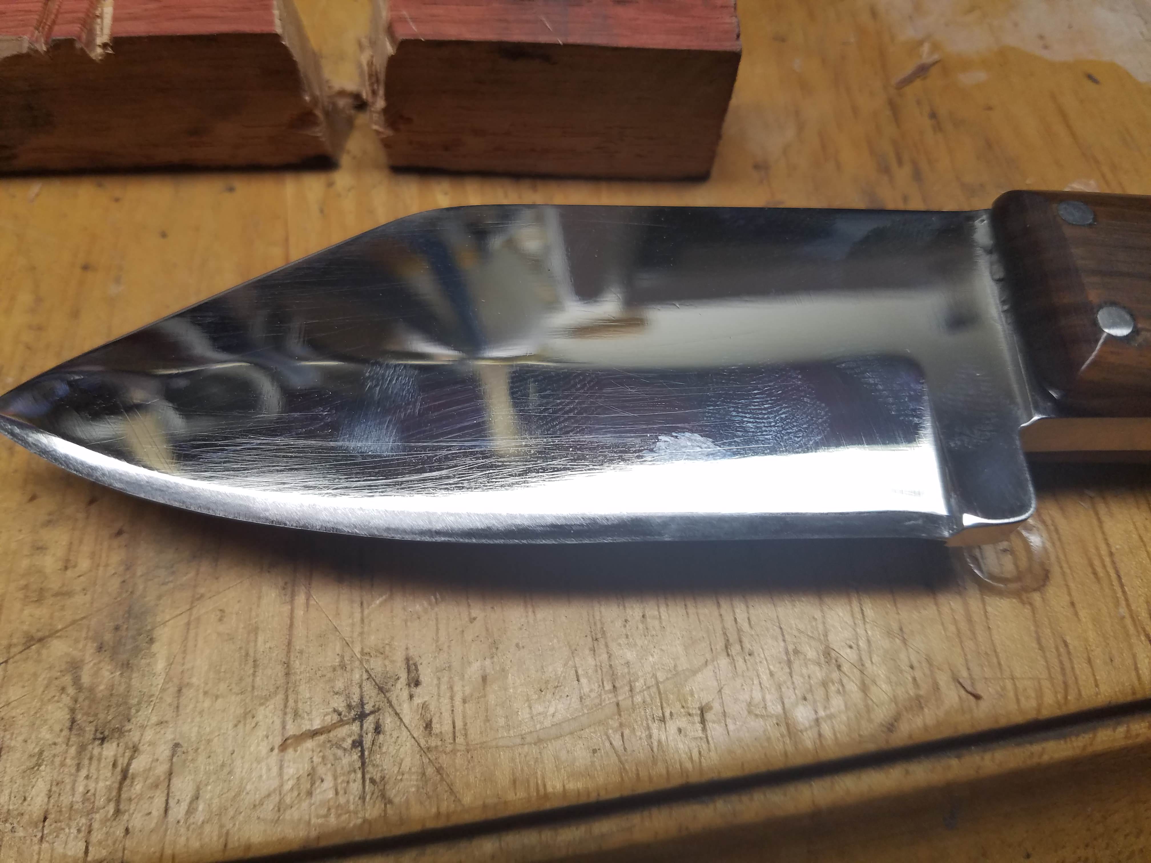

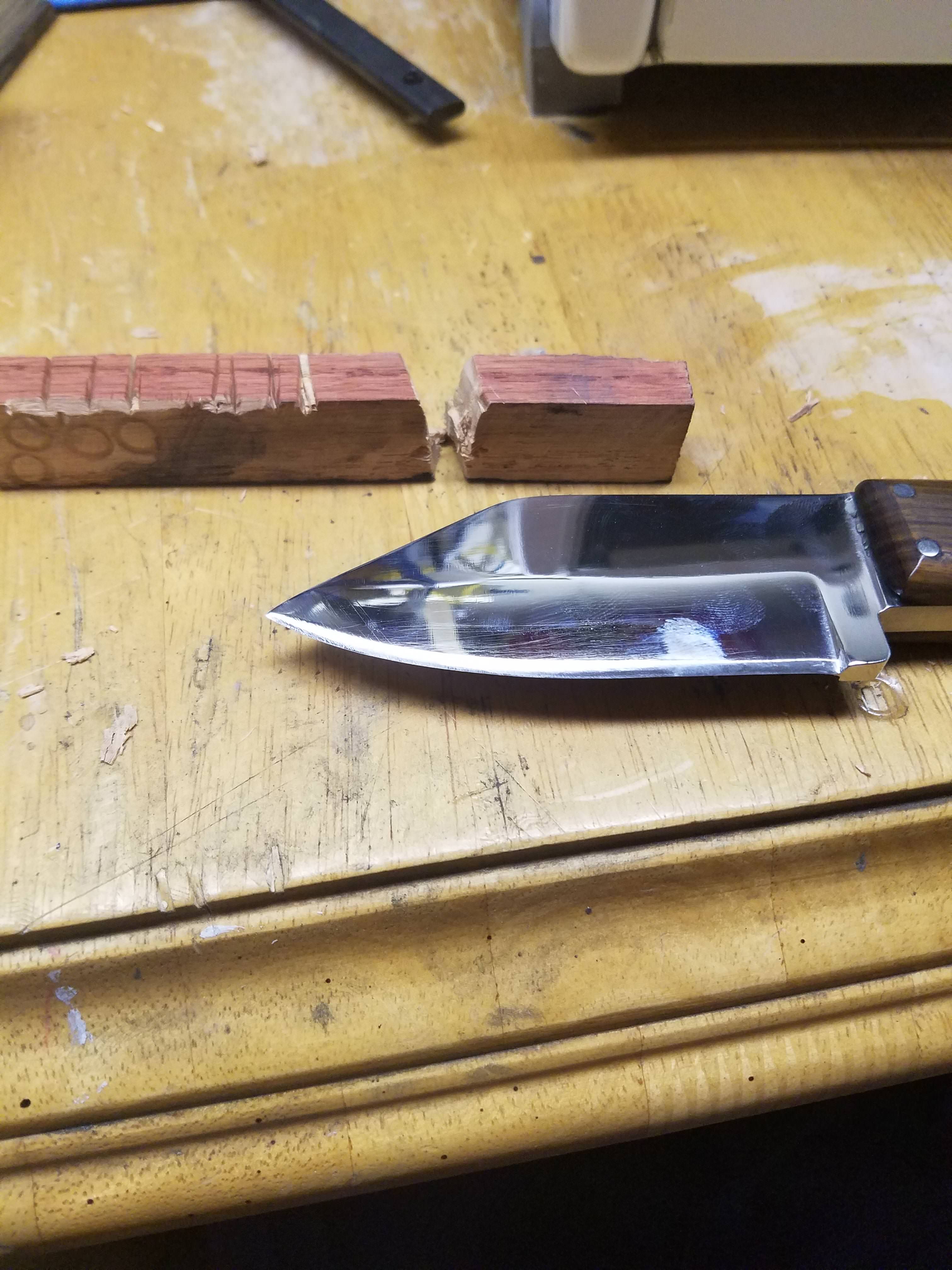

Try carving some hardwood. See if the edge chips. Probably not worth redoing. Just do it right the next time.
I am no maker or steel expert but I think at this point the question for this knife should be is there anything wrong with 5160 @ 62-64RC on a 3.5" blade? If the answer is no then keep it move on learn for next time to hit a perhaps more "ideal" HRC for the size and steel.
I agree pirate. I believe I will keep it as is and give it to my dad for his birthday. I did try to batton through some hardwood. (That is pretty tough) after I was finished the blade is fine and still shaves hair from my arm.
Based on your batoning, I'd leave it just as it is. Your Dad will be proud of it because you made it.
