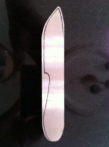

For anyone who was curious here is where it was at the other night it's been slow going with only files to shape it out but it's starting to resemble a knife.

Made some progress on this I need to pick up some sandpaper and get my hands on a working drill (both batteries for mine decided to give up their ghost). After I get some sanding done and some holes drilled I plan to start working on the primary bevel.
I am planning on a full flat grind hopefully with a distal taper on this on using files. I have a single cut (mill) bastard file and I was wondering with the 3/32" O1 steel should I just draw file from the get go on the bevel or should I establish it first with more typical file work?

I would just file and sand it carefully. It is short, so draw filing won't be as easy or effective. You are only taking about 1/32 off each side at the edge, so it will be a few file strokes and then a sanding block. I would not worry too much about the distal taper, as it will sand in sort of naturally on a blade that thin and short. DO NOT SAND THE BLADE 100% to thickness and taper before HT, as you will be taking a bit more off after HT. 90-95% is as close as one dares. If you don't heed this, the final blade will end up either with a poor finish, or thinner, shorter, and narrower than planed.
