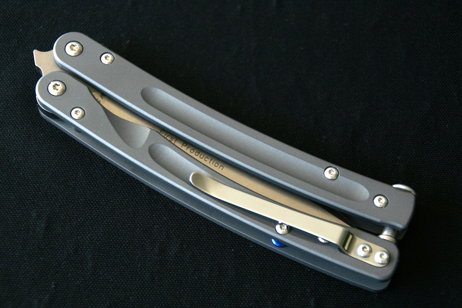

MY BM 51 is damn near perfect, no play
The only thing that they failed at was to use screwed stop pins instead of solid ones, i dont really trust such a tiny double screw construction
Also the tang is rather tiny right behind the edge, not a knife you want to chop firewood with
I love the simple clip and the machined pattern on the liners
