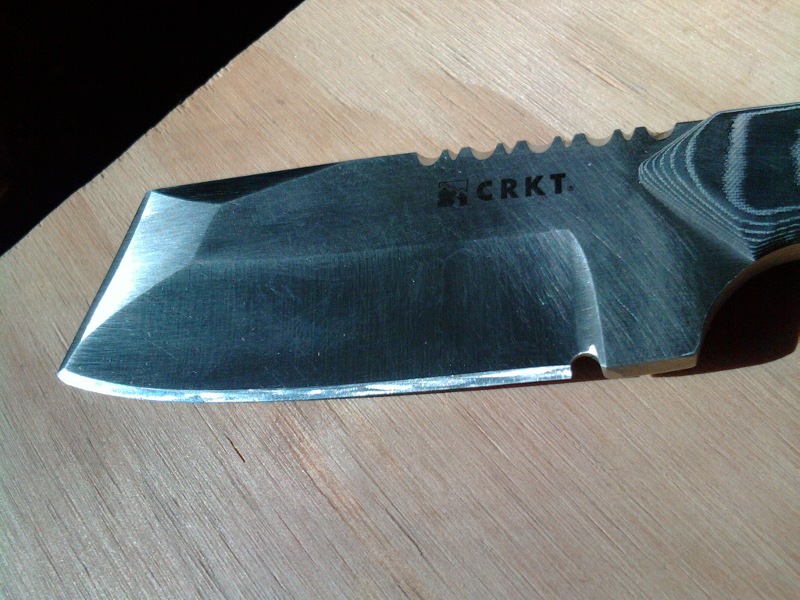

I just re-profiled the CRKT ringed razel I got yesterday. It was badly out of balance for the main bevel. Took a while with the 120 stone to get it down. Then I polished that up and put a secondary bevel edge on it. It is now indeed sharp.
Put a nice 1000 grit edge on the Benchmade 741 and ran three steps with the CRKT Crawford/Kasper and got that into shape as well.
This works very nicely. Cheap? No. Happy with it? Yup.

A lousy phone pic, but this looks better in person than in this image and it's only 1000 grit and my fifth or so blade I've ever done with the EdgePro. I had to totally reprofile with 120 grit to get the primary bevel even on both sides too.
It's not air bleeding sharp or a pocket mirror, but it's really freaking sharp. Takes teeny hairs off the edge of my desk and sheets of paper flee.
